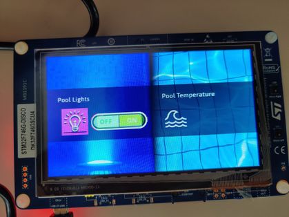

I am facing some problems with TouchGFX 4.24.1.
After creating a project from Demos -> Board Specific Demo and selecting the STM32F746G-DISCO, and selecting the project: STM32F746G-DISCO Control LED from GUI. I got two problems:
- Problem 1: Frozen Screen and incorrect display of toggle button and light icon

The light toggle button is not showing correctly and not interacting from the touchscreen.
- Problem 2: incorrect display of toggle button and light icon
After opening the project with STM32CubeIDE 1.16.0, compiling and running the project. It interacts but the LED icon and the toggle button are still displaying incorrectly.

Hello @janid_a ,
The issue occurs because that board got a new revision, it's memory got changed.
A new TBS (TouchGFX Board Setup) is available in TouchGFX Designer, therefore you should not face the issue anymore.

Flashing using the programmer or the IDE both running and Debug mode results in Problem 2; It is possible to interact with the toggle button by turning off and on the pool light , but the icons are not displayed correctly (Green and ugly).
I tried generating other demos or examples from the TouchGFX by specifying the Board, generating the code, running to target and they don't work!! (Also by opening the project with STM32CubeIDE).
Since it works on my side and it doesn't work for you on other demos and IDE, I would assume this is an issue with either your computer (compiler, dependencies, etc) or with your board (previous surtension, static electricity, etc).
Can you try on a different board or computer to try to isolate the issue?

I made the test creating a project from Examples in ToughGFX, and selecting the Board STM32F746G. Using the Flex Button Example.
I did the test with two versions of the STM32F746G board: MB1191-F746NGH6-C03 and MB1191-F746-C01
  • On MB1191-F746NGH6-C03:  Either flashing with TouchGFX or STM32CubeIDE I get this result
  • On MB1191-F746-C01:
    1. If I flash the board using TouchGFX Program and Run Target, the display shows properly but it does not interact after touching the light toggle button.
    2. If I build and flash it using the IDE. it works properly.
It seems that the MB1191-F746NGH6-C03 has some issues. I will try with other C03 Boards and see if I can replicate the problem.

I see that the washing machine example functions correctly on B04 hardware, but the C03 hardware has issues with the colors being off and the bubbles on the screen saver render as pink boxes with a sphere in the middle. Not the correct Blue.
Could this be due to the C03 using a RGB888, instead of RGB565? Looking at the schematic for the C03 it has all R[0:7],G[0:7],B[0:7] connected to the display.
What kind of "compatibility issue" should we be looking for?
