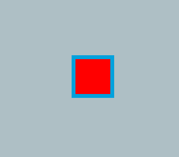

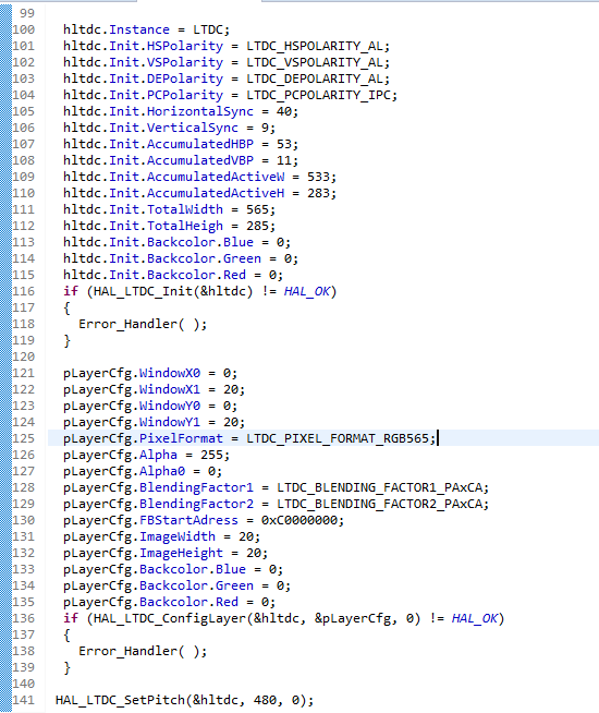

i have done some experiments on 746Disco board. I have configure the LTDC as shown below.
In TOuch graphics i got 20x20 canvas in designer. Then i just plcae a RED colour box i this of dimensions 20x20.

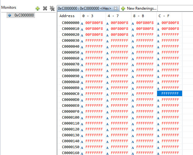

Then after build project then go to debug in cube iDE it works fine on board a red box is displayed on screen of 746Disco. Then in debug when i check the frambuffer contents these are as shown below.
i have a question now.
it is showing 0x00F800F8 means for one pixels in RGB565 it is 0x00F8. According to me it should be 0xF800 for RGB565. so please clear this one .

Correct, 0xF800 is Red in RGB565. (Or 0x00F8 because of endianness)
