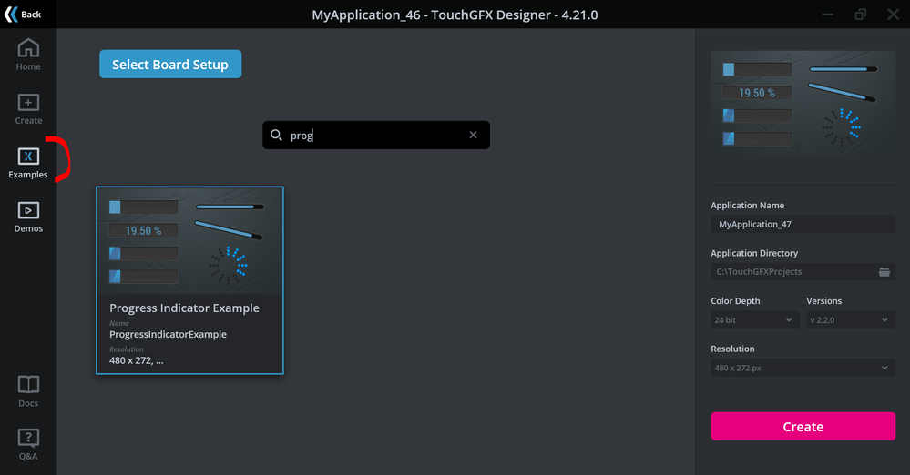

Im working on implementing a busy loader using TouchGFX circleprogress bar indicator
Have a look at the Progress Indicator Example in TouchGFX Designer and at the relevant articles in the online documentation.
0693W00000Y8MlQQAV.pngThis example will show you how to interact with these widgets and will contain some code you can use for your project.
