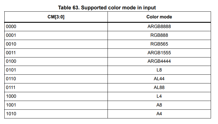

I'm using the development board STM32L4P5G-DK. My development board uses display type RGB222(6bits) <--device configuration tool(its the only option). My LCD display makes use of 24bit RGB data(RGB888 input format). Controller uses the following outputs: R7,R6,G7,G6,B7,B6. I have connected it to R7,R6,G7,G6,B7,B6 of the display, the rest of RGB data signal of the display is connected to ground. In device configuration tool of STM32Cube IDE i use the pîxel format RGB888(layer 1). I only use one layer.
About lcd-image-converter:
1)Wich image format(png,bmp,jpeg,etc) is recommended to use for converting an image to C for STM32?
2)Wich "main scan direction" to use(top to bottom, bottom to top, left to right,etc)?
3) In the application note 4161 they recommend to use Image -->block size: 32 bit: is this correct?
4)Wich preset option to use, "R8G8B8" or an other?
5)In Image-->Common -->application note 4161 shows to use "split to rows". Is this correct?
Could someone help me.

Hello @FLuba.1​  and welcome to Community :) ,
The LCD image converter tool supports different image format such as bmp, gif, jpeg, png ...
You can use any image input format or any main scan direction.
It is important to use an image size aligned with the LTDC Layer1 configuration.
For fast read and conversion, it is recommend to use block size 32 bit.
Depending on your needs, you can choose the preset option.
If, in your application, the LTDC synchronization with DMA2D and CPU, you must choose preset that is supported by DMA2D as shown in the below table.
