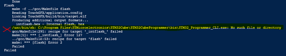

how and where can I change the path to the STM32CubeProgrammer in TouchGFX Designer?
After hitting the Run Target Button (F6) the TouchGFX Designer fails downloading the flash file due to not find STM32_Programmer_CLI.exe.
This is because the default installation path is "C:\Program Files\STMicroelectronics\STM32Cube\STM32CubeProgrammer\bin\STM32_Programmer_CLI.exe"
My installation path is "C:\ST\STM32CubeProgrammer\bin\STM32_Programmer_CLI.exe". The TouchGFX Designer Settings do not provide path settings. Where can I edit this?
Must be some sort of config file.
My workaround is just manually flashing the file using CubeProgrammer and browsing the target file under "C:\TouchGFXProjects\MyApplication_1\TouchGFX\build\bin"
There is a intflash.hex and a target.elf. Both do the same job as I figured out.
TouchGFX Desinger V 4.17.0
Target STM32F429 Discovery

I have also this problem, but my path is on D disk. I found solution.
In application folder, ("C:\TouchGFXProjects\MyApplication_1\") go to "gcc\include", here open cube_programmer.mk with notepad and change variables related to your problem. In my case I changed "program_files_win64" from "/c/Program Files" to "/D/Program Files" and now is working.
I hope that my solution help.
