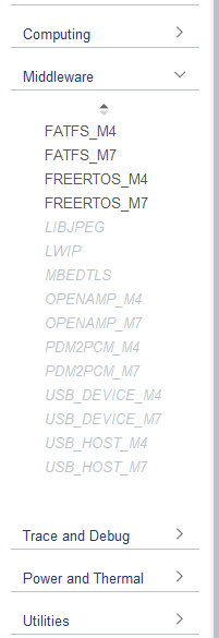

I also tried to use STR32CubeMX app to add the STemWin library. I selected STM32H747I-DISCO board, but it does not contain STemWin middleware:
0693W00000D1cexQAB.pngCan you tell me what I am doing wrong?

In fact, STemWin was removed from CubeMX since V5.5 release.
So, STemwin is not supported in CubeMx.
I will check internally your ticket and come back to you soon with update.

I have the same problem: I'm not able to add STemwin library in a custom board with STM32F103RTC.
AN4223 it is completely useless as it relies on how to adapt a project that already contains the library.
The examples contained in STM are not clear (and the SMT32CubeIDE does not import them correctly), in addition the removal of the STEMwin from the CUBEMX has actually removed the support of this library. Why indicate it as supported?
