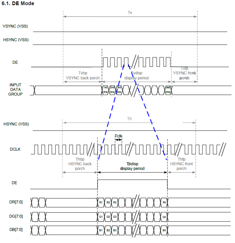

My MCU is a STM32H753BIT6. This is a custom board that works fine with SYNC-MODE displays types.
I have a new display only works in DE MODE. It not requires the HSYNC or VSYNC signals.
Is there any way to configure LTDC peripheral and TouchGFX to work only in DE MODE? This is a communication image about this mode.
I disconnect physically the VSYNC/HSYNC signals and ground it to make sure.
Thanks for any tip and help!

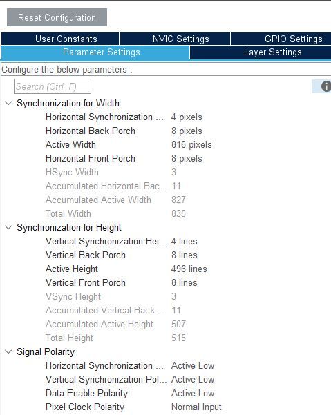

Best answer by uilter
It works =)
I change the settings to:
Also I reconnect the VSYNC and HSYNC signals to LTDC peripheral. Without it the display keep dead.
Just after these modifications that I mentioned it worked.
I had some flickers in transaction screen and animation widgets, but reducing a little bit the LTDC_CLK it works well. (Fine tuning)
@ktrofimo​ thanks to help me with it.

What is your display model? Do you have datasheet? I would start with comparing "hsync/vsync" and "de only" waveforms...

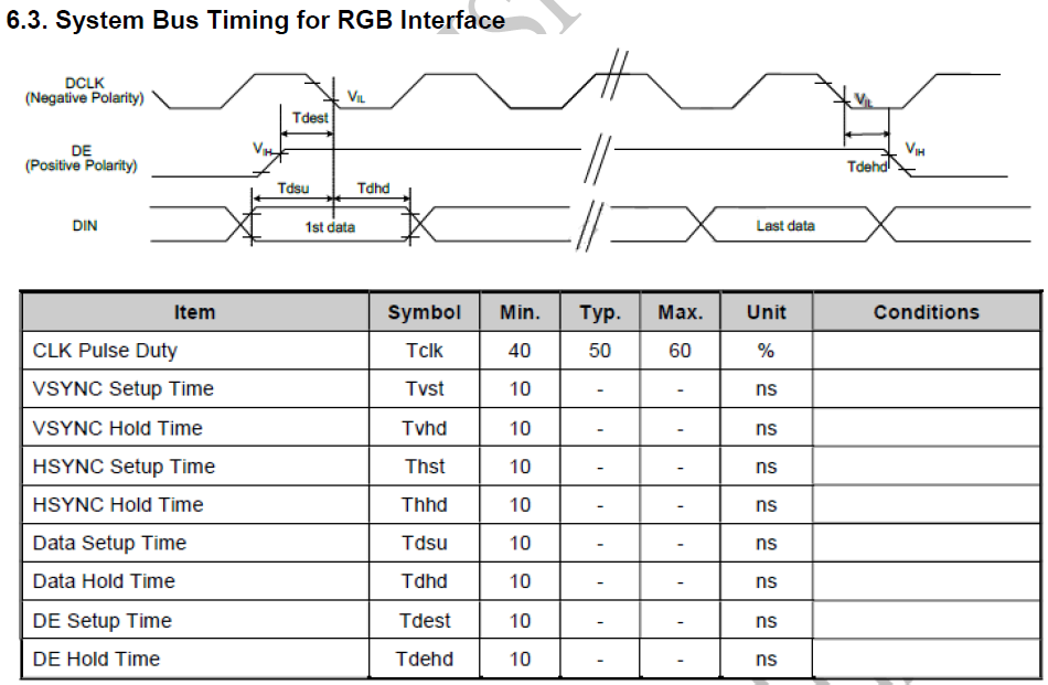

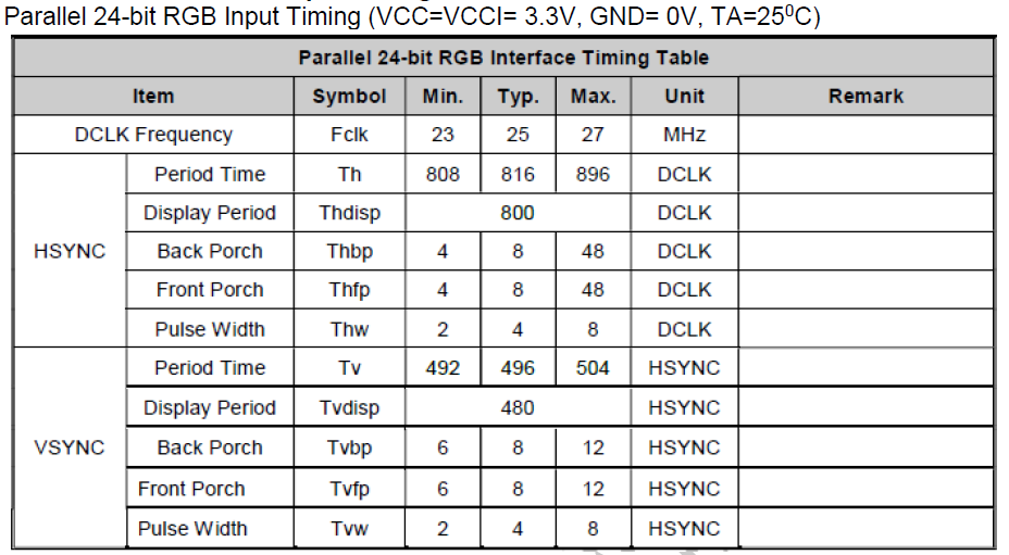

I can not upload the file here, just some prints.
This is the timming table
Resumed pinout: note there is not VSYNC and HSYNC

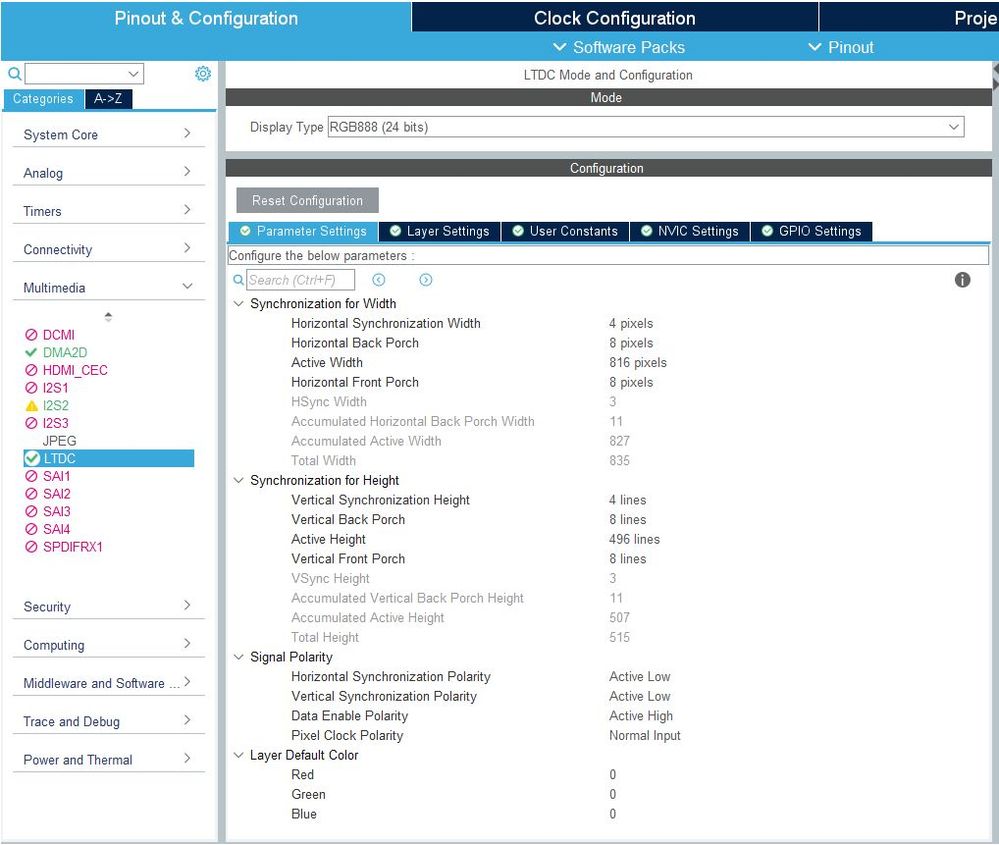

_legacyfs_online_stmicro_images_0693W00000bViUoQAK.pngThen my CubeMX setup (My LTDC clock is 25MHz):
Let me know if you need more informations.
Thanks.

What about display model? According to information you posted here it should work as regular TFT just without HSYNC and VSYNC signals. If you can't publish document - just give a model and/or link to the datasheet.

Hi .
I am using both type of TFTs ( with VSync + HSync + DE ) and also DE mode only
you dont need to disconnect the connection of VSync & HSync for DE Mode.
Just put the value 1 for each i-e VSync =1 & HSync = 1 in CubeMX
these values always -1 of actual value , that means 1-1 = 0 >> DE Only Mode.
I hope this will work

When you sad "put the value 1 for each i-e VSync =1 & HSync = 1 in CubeMX" is set the polarity in LTDC configuration to Active HIGH or set the GPIOs to output and config it to HIGH state?
Thanks.
INaee.1
June 8, 2023
Hi
my experience is ....
You can't disable the LTDC essential signals and set as gpio output , if you do so then whole LTDC becomes inactive in cubemx.
The Vsync & Hsync signals can be disabled by putting value 1 for each , as I mentioned before and practically observed.

February 14, 2024
I tried adjusting display settings and display works!.
