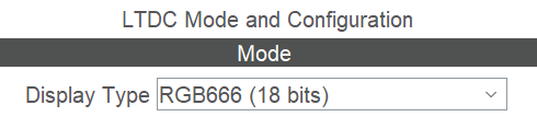

My problem is simple, probably silly. I couldn't find any answer, even in other working projects from the net. I can't enable TouchGFX in Middleware (I can only enable STemWin Display Bus Interface using FMC). What am I missing:
1.Connectivity->FMC

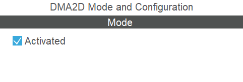

2.Multimedia->DMA2D
3.Multimedia->LTDC

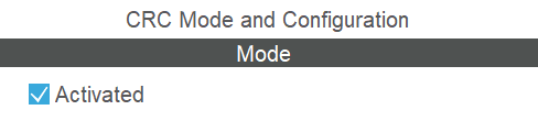

4.Computing->CRC

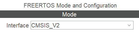

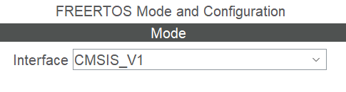

5.Middleware->FreeRTOS
And TouchGFX is still faded. What is wrong? I've checked DataSheet, Reference Manual, Errata, TouchGFX site, many other sites and somehow I am still missing something. Can you point my mistake?
