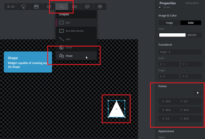

Hello @Wiser1201 and welcome to the community!
TouchGFX provides a way to draw triangles (or any polygon) with the shape widget :
To add triangles at runtime, you should use the add function (make sure to delete them after with the delete function).
However, it is not recommended to dynamically add widgets at runtime in embedded devices because of memory problems/limitations.
If you still want to go this route, you can know more in those threads:
- https://community.st.com/t5/stm32-mcus-touchgfx-and-gui/possibility-of-dynamically-creating-ui-components-pre-screen/m-p/657347
- https://community.st.com/t5/stm32-mcus-touchgfx-and-gui/adding-containers-widgets-not-declared-in-screenview-hpp/m-p/681913
- https://community.st.com/t5/stm32-mcus-touchgfx-and-gui/how-to-add-custom-container-during-runtime/m-p/642792
- https://community.st.com/t5/stm32-mcus-touchgfx-and-gui/add-widgets-line-etc-at-run-time/td-p/100166
If that answered your question, I invite you to select this message as "best answer". :smiling_face_with_smiling_eyes:
