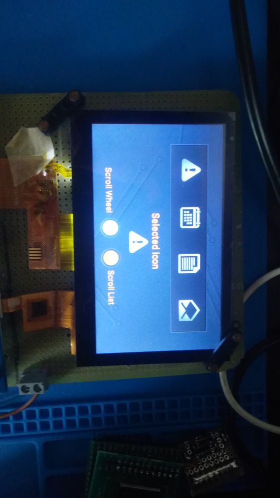

‎2021-01-07 6:20 AM
Hi all.
Finally my simple project works!!! thank very much at all !!!

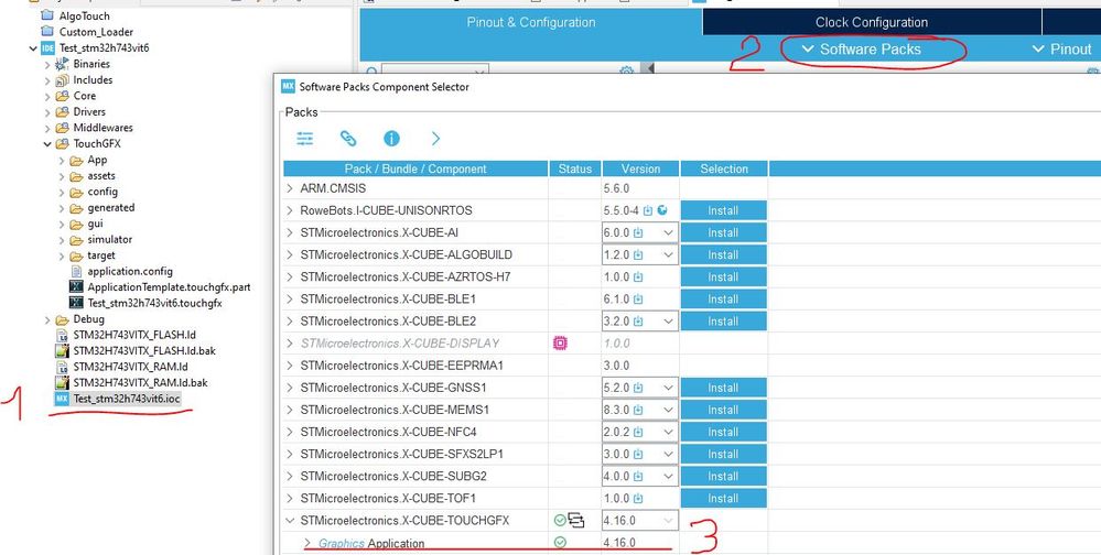

I want to share with you which was the problems:
1) FREERTOS = I changed some "Config parameters" copying H743-EVAL settings
2) FREERTOS = i changed Heap size, I replaced the StartDefaultTask with TouchGFX_Task and increased stack size to 4096
3) I checked if TouchGFX_Task function wasn't present MX_TouchGFX_Process();
4) on SOFTWARE PACKs--> TOUCHGFX 4.16 = I changed Buffer Location setting to "By Allocation" instead of "By address = 0x24000000"
5) on LTDC --> Layer Settings = I changed Layer 0 - Color Frame Buffer Start Address from 0x24000000 to ZERO
After those editing, projects start without any problem. It is evident that I need more time to study this amazing device.

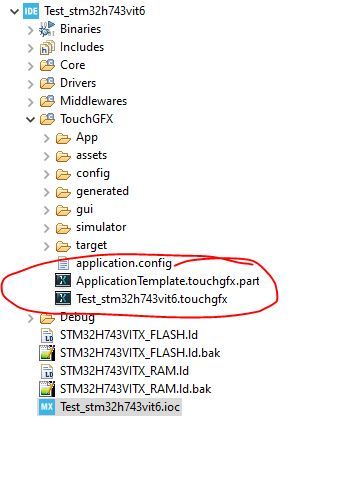

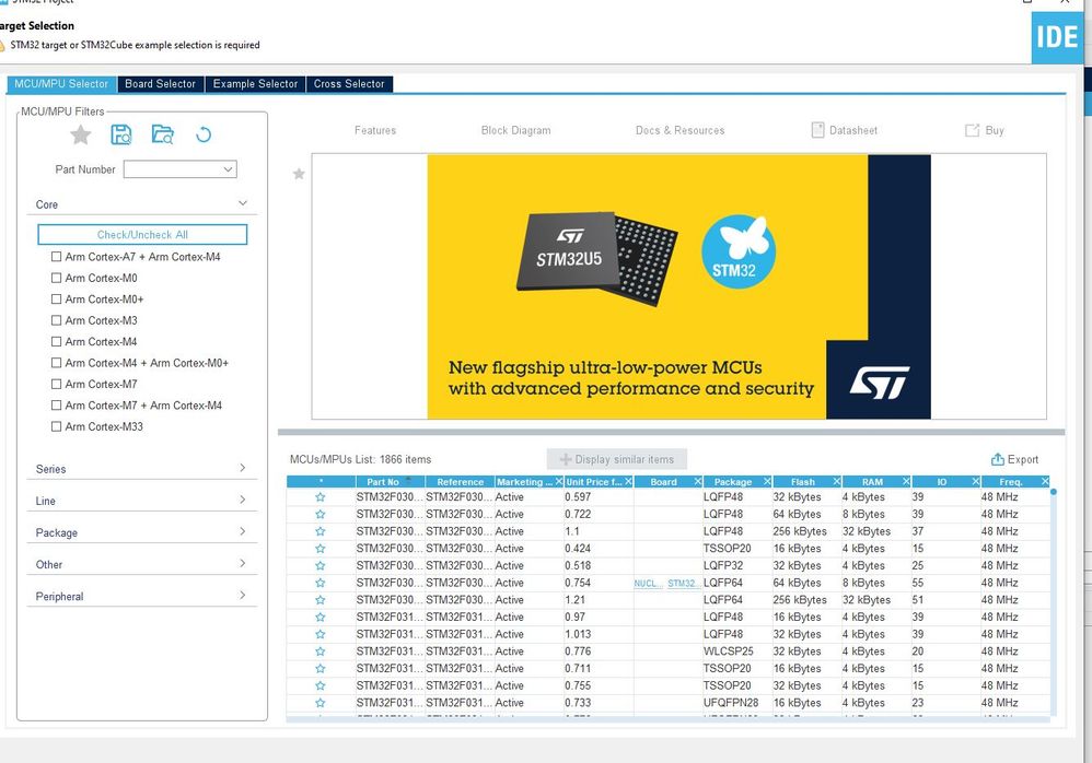

In attachment I inserted an Empty project configurated for STM32H743VIT6. This project has the minimal configuration to active LCD drivers and to show a simple graphic example.
I would like to hint to you to use STM32IDE and create a new "STM32 project"
And choose your device . Into a second step, you can load the "device configuration tools" to enable and active all the peripherals you need.
When you enable Touch GFX, ide create an empty graphic project.
This is your start point.
All It's very simple. You don't need to do anything else.
