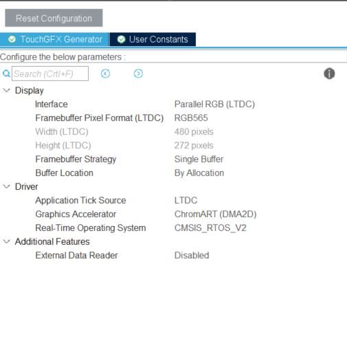

0693W000008yYHDQA2.jpgHello MPast.1
Thanks for your help, but i still have some problems.
as you did, i followed all of steps of below as well.
I'm using the TouchGFX 4.15 instead 4.16
1) FREERTOS = I changed some "Config parameters" copying H7B3DKsettings -> DONE
2) FREERTOS = i changed Heap size, I replaced the StartDefaultTask with TouchGFX_Task and increased stack size to 4096 -> -> DONE
3) I checked if TouchGFX_Task function wasn't present MX_TouchGFX_Process(); -> -> DONE

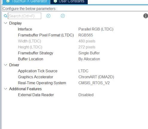

4) on SOFTWARE PACKs--> TOUCHGFX 4.15 = I changed Buffer Location setting to "By Allocation" -> -> DONE

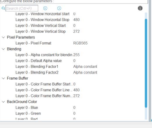

5) on LTDC --> Layer Settings = I changed Layer 0 - Color Frame Buffer Start Address to ZERO -> -> DONE

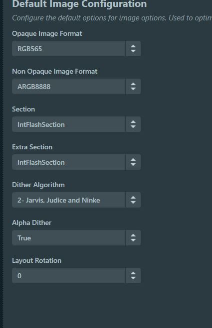

In TouchGFX Designer i changed to Internal Flash
One last thing that i saw is the files FLASH and RAM ".ld"
FILE FLASH.LD
/* Entry Point */
ENTRY(Reset_Handler)
/* Highest address of the user mode stack */
_estack = 0x20020000;  /* end of RAM */
/* Generate a link error if heap and stack don't fit into RAM */
_Min_Heap_Size = 0x1000 ;   /* required amount of heap */
_Min_Stack_Size = 0x1000 ; /* required amount of stack */
/* Specify the memory areas */
MEMORY
 FLASH (rx)   : ORIGIN = 0x08000000, LENGTH = 2048K
 RAM  (xrw)   : ORIGIN = 0x20000000, LENGTH = 128K
 AXI_SRAM (xrw) : ORIGIN = 0x24000000, LENGTH = 1024K
 AHB_SRAM (xrw) : ORIGIN = 0x30000000, LENGTH = 128K
I really don't know, if i have to change this part to increase the RAM size or the CUBEIDE make this without any changes.
