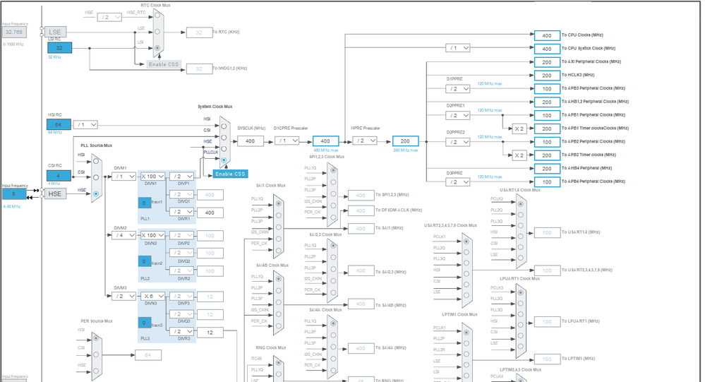

I'm using STM32H743IIT6 with LTDC configurations and when I'm using internal clock, LTDC works fine but when I use external crystal nothing works . What can be the problem?
Options
2020-10-04 3:15 AM
And when I'm going to find the problems using DEBUG mode it gives me this error:
Cannot access Memory
*** error 122: AGDI: memory read failed (0xFFFFFFFE)

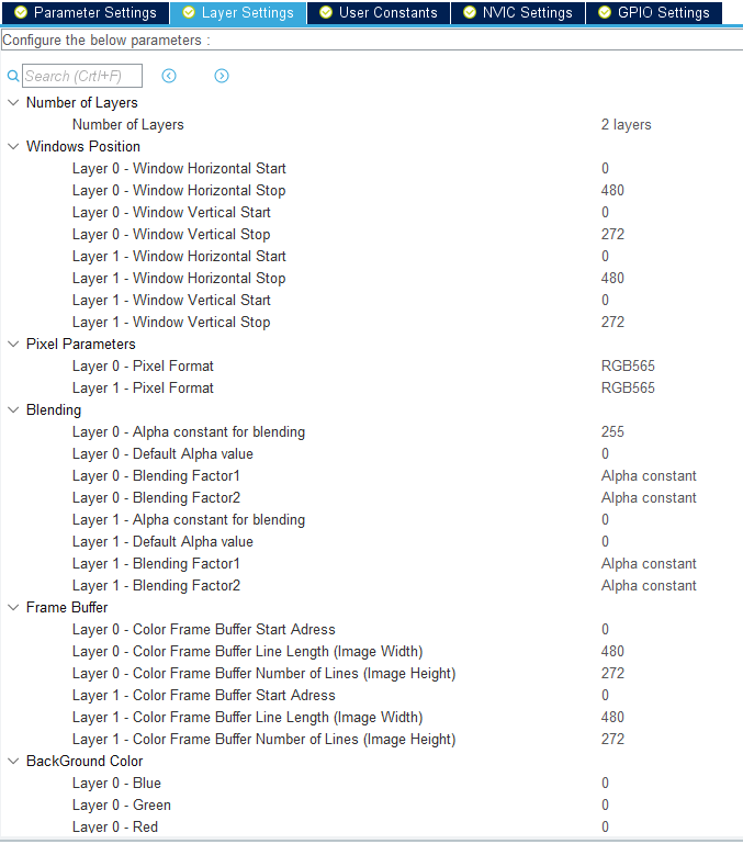

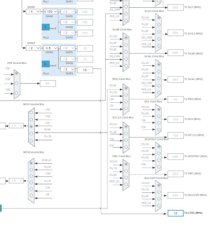

And this are is LTDC configuration and Clock configuration:

?? Frame buffer start address 0 ?? and why two layers
for your size and dot clock frame rate is 90Hz , isnt to big? Try change 12Mhz to 8MHz...
