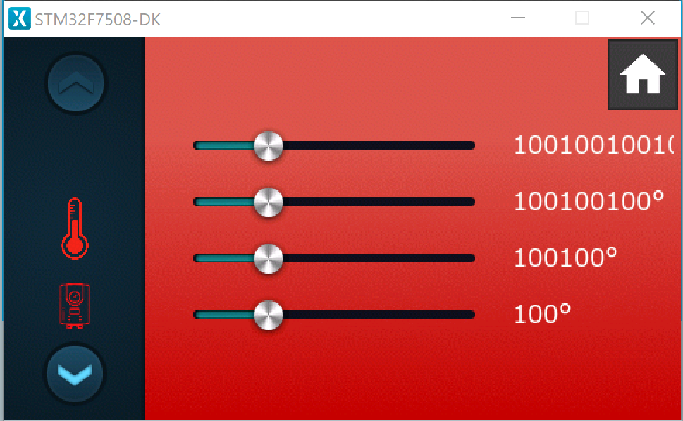

Hello, I'm trying to add multiple sliders within a vertical slide menu, but values of the respective sliders on the right always include the subsequent values of the slider below it. Is this possible?
LBend.1
A singular slider works fine in the page. I've tried many callback/handler methods (individual for each slider, combined with cases), but can't seem to be able to fix the issue.
See my attached pageSetupView.cpp and pageSetupView.hpp functions pertaining to the sliders.

0693W000008wauhQAA.pngMaybe I'm missing something? Thanks!

Hi Romain,
I used the "Slider Example" as the building blocks for this. However when adding additional similar like (all horizontal sliders) my example fails. Could it have anything to do with the same generic 'Slider' callbacks (setStartValueCallback, setNewValueCallback, setStopValueCallback) each referenced 4 times (for four sliders) like the following? If that's the case is there another way to notify when a slider has changed? I tried independently named callbacks for each zone too (i.e. zone1sliderValueStartedChangeCallback, zone1silderValueChangedCallback, zone1sliderValueConfirmedCallback).
zone1Temp.setStartValueCallback(zonetempsliderValueStartedChangeCallback);
zone1Temp.setNewValueCallback(zonetempsliderValueChangedCallback);
zone1Temp.setStopValueCallback(zonetempsliderValueConfirmedCallback);
zone2Temp.setStartValueCallback(zonetempsliderValueStartedChangeCallback);
zone2Temp.setNewValueCallback(zonetempsliderValueChangedCallback);
zone2Temp.setStopValueCallback(zonetempsliderValueConfirmedCallback);
//...etc.
Thanks!
