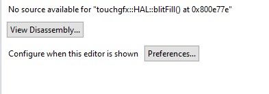

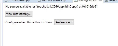

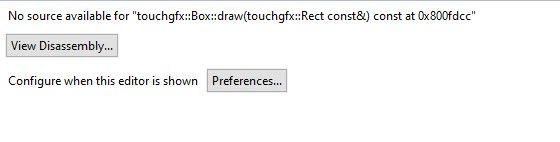

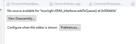

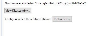

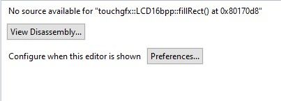

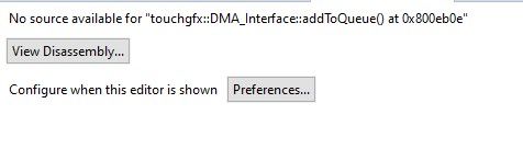

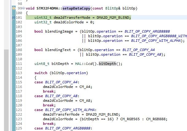

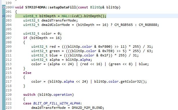

@Flemming Gram CHRISTENSEN​  When I install ChromART, the program enters the functions STM32F4DMA :: setupDataFill (const BlitOp & blitOp) and STM32F4DMA :: setupDataCopy (const BlitOp & blitOp). But I get "No source available for ..." errors about some functions. I have encountered problems with pictures. But my main problem is how do I know if ChromART is running successfully?
If you're hitting setupDataCopy/Fill and what you're seeing in memory or, more easily, on the display is correct - Then chromart working. You can do more concrete experiments, but if you're hitting those functions then chromart is handling filling boxes and moving image data from flash to framebuffer.
Some parts of your stack trace come from the library and you do not have the source for that. By design.

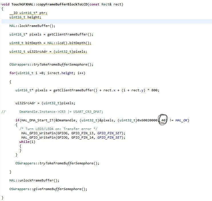

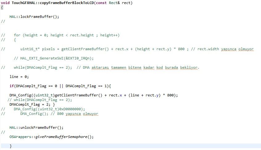

Thank you for your answer, Mr. @Flemming Gram CHRISTENSEN​ . I'll try this. In the meantime, I will ask you another question. As seen in the picture, I am trying to transfer the pixel data to FMC with DMA. But when I enter the data length more than 40, the DMA function becomes Busy. I can't figure out the reason for this.

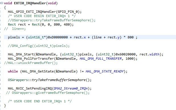

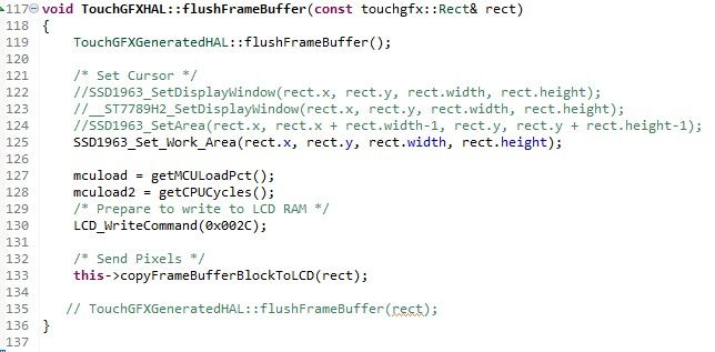

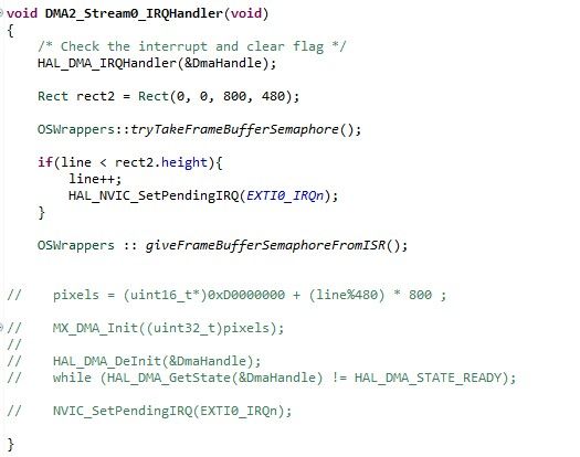

Finally, I can transfer 800 bytes of RAM to FMC with DMA. But I want to transfer data with DMA interrupt. I'm running into a problem here. Normally, I transfer DMA with the 'for' loop inside TouchGFXHAL :: flushFrameBuffer. Since I cannot use the 'for' loop in the interrupt, I also used software interrupt. But it hasn't been as successful as the other and has severe pixel shifts and flickering. Related cuts are available in the pictures. I would be glad if you help me in this regard.

Maybe it is busy because it is transferring data? I don't see that you are waiting for the DMA for i=0, before starting for i=1.
Try something like this
for (i=0;i<height; i++)
pixels* = ...
HAL_DMA_Start_It(...);
semTake(fmcDMAsemaphore); //lock UI thread until DMA has finished
and then in the DMA interrupt, signal the fmcDMASemaphore.
This way the UI thread is sleeping while the DMA is running. Other threads can run meanwhile.
Other synchronization primitives can also be used. But if you are busywaiting on the DMA here, then you could also just write the data with the cpu.
