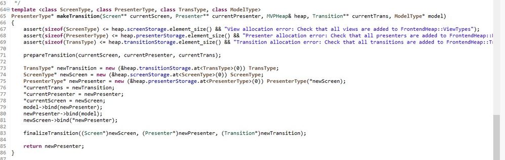

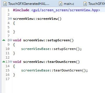

I should also mention that my code doesn't fall into the functions screenViewBase :: screenViewBase () and screenView :: screenView (). Can you explain how to access these functions with interrupt? @Flemming Gram CHRISTENSEN​  @Martin KJELDSEN​ 0693W000006G8N4QAK.jpg0693W000006G8MfQAK.jpg0693W000006G8MVQA0.jpg
I could access these functions in my works with the STM32F429's LTDC screen. But as there is a problem with my FMC configurations, I cannot access these functions via interrupt.
If you're not getting touchgfx_signalVsync() called, then TouchGFX isn't running and nothing will happen on screen. Check out the F412 AT for inspiration on FMC config..
But it's more likely that you need to wire an external signal from your display to call this function that drives touchgfx forward. For LTDC it's easy since it's on the MCU and can be configured to fire interrupts easily. We provide the LTDC driver for all MCUs, but for SPI/FMC/DSI we cannot - yet
You are right Martin. With a LTDC display you get a "refresh" signal from the LTDC controller. With a display on FMC you normally use an external signal from the display (an extra line going from the display to the MCU). This is asserted by the display when a refresh starts.
The standard procedure is to hook the external interrupt to this line, and then start TouchGFX drawing. I.e. calling touchgfx_signalvsync (in above pictures) from the interrupthandler.

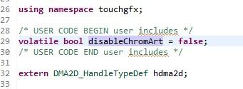

I enable ChromART in CubeMx while creating the project. ChromART interrupts are working properly. It appears to be enabled in the code snippet in the picture. But I can't tell if it's working or not. Do I have to do something extra? I cannot understand this as I cannot display the CPU working percentage on the screen.

You can check if it is being used by setting breakpoints.
E.g. in the DMA2D interrupt. If this is executed it is running.
Another good place could be in SetupDataCopy/SetupDataFill in your DMA class (STM32DMA.hpp)
The setupDataFill is called if you have a few Boxes on your screen.
