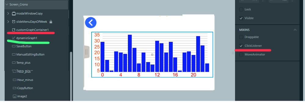

MPast.1
Senior II
Hi Romain,
I added a custom Container over a graph and I enabled ClickListener on the custom Container. Obviously the custom container has the same size as the chart box
0693W000008zr8MQAQ.pngBut not events are generated.
I have void Screen_CronoView::handleClickEvent(ClickEvent& evt) routine and
virtual void handleClickEvent(ClickEvent& evt) prototype.
I'm sorry but I don't understand what i'm wronging or what I'm missing.
Do you have some hints?
thanks
