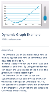

Do you have an array of all the data points for your audio spectral graph?
Have you tried the graph widget?
Depending of the number of points and if you're running on STM32N6, performance should be ok, but if not I have another suggestion which is to use a custom vector renderer class that can draw more than 3000 points and keeping a good rendering time. I have a project that I can share with you later if you need that, but first I think the graph widget should be tried.

Hello @carlosdelfino ,
Ok and what about my suggestion using the graph widget? Have you tried that? If you need help to get started, we have a example in the designer which you could get inspiration from.

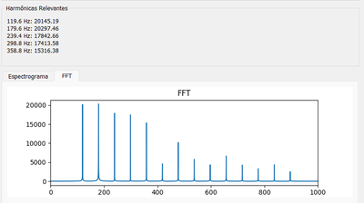

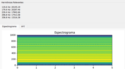

I need a spectrogram; I made a simulator with Python. The first image below shows the spectrogram I'm trying to create in touchgfx, while the second image, which is the FFT, I can do without problems.
Image 1:
carlosdelfino_0-1770670630577.png'
Image 2:

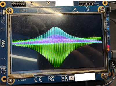

I am able to do this on m STM32N6570-DK board :
It is made of 800 x 3 = 2400 points , and  render time is around 6ms.
I'm using VectorRenderer class to draw this. Let me know if you want me to share my project with you.

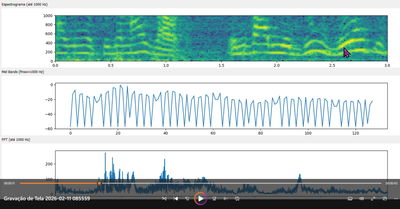

The graph I need is a Spectral graph, which has 3 dimensions: Time (x), Frequency (y), and magnitude (colors). As in the image below, the first is spectral, the second is Mel Band obtained from Cepstral, and the third is FFT:
VectorRender comes very close, but an expert wouldn't have immediate insight into what's being represented.
I'll study VectorRender because it could be valuable in another case.
