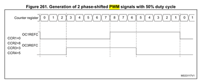

I am trying to create two phase-shifted PWM waves on an STM32L4 TIM1 using asymmetric mode. From what I understand, I have to:
enable output on GPIO channels 1 and 3
enable output compare 1,2,3,4 and output compare 1,2,3,4 as asymmetric PWM mode
Then, I set
CCR1 = 0, CCR2 = ARR, and CCR3 and CCR4 to the outputs provided by the function below.
Then I only enable channel 1 and channel 3 as outputs..?
So output compare 1 and 2 work together to produce the first PWM on channel 1. And output compare 3 and 4 work to produce the second PWM on channel 3.
This is what I understand from the graph on page 754 in the RM. But it is not allowing me to change the phase shift while still maintaining 50 % duty cycle on both waves. When I print my CCR3 and CCR4 values, they are exactly ARR apart, which would make me think that they should produce a 50% duty cycle wave. But they don't.
I'd appreciate any help!

Are you trying to duplicate this?
Note that CCR3 and CCR4 are not ARR apart.
Should select CCR3 to get the desired phase offset and then set CCR4 = ARR - CCR3.
