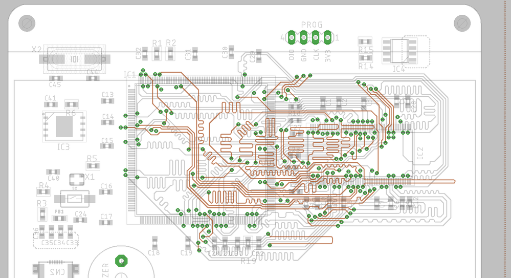

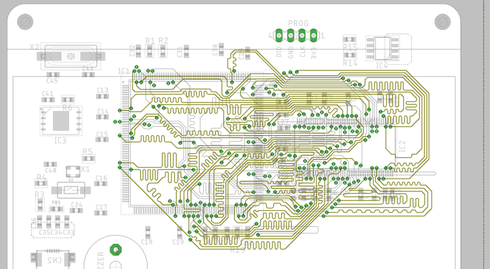

Best PCB design of FMC for STM32F746 and IS42S32400 SDRAM
MiladChalipa
Senior
Recently, I'm working on a 6-layer PCB design of STM32F746BGT6 and 128Mbit SDRAM with LTDC ( 4.3" LCD 800x480) and so far I connected the FMC bus traces with 12mil clearance (Reduce crosstalk) and 6mil width(50-ohm transmission line). My board Stack-up is 1-signal/power 2-ground 3-signal/power 4-ground 5-signal/power 6-ground and noted that FMC signals are in the 3rd and 5th layers.
I also do the length matching for all FMC traces to be 70mm but I'm wondering that maybe routing all the traces in such a small area could cause EMI or signal integrity problems?
any suggestions from PCB experts will be appreciated.
/Milad

Hello
Signal propagation speed for FR4 microstrip is about 0.5*C or 1.5E08 m/s (C= speed of light )
This means a propagation delay of 66 picosecond per cm. (1cm/speed)
I wouldn't worry about the exact length matching , since Data-Address Setup and Hold times for this memory allow not so tight skew.
@Vangelis Fortounas​ Thanks for your reply
So The Wiring is good in your opinion, I had a bad experience with this type of RAM before and decided to make everything as good as possible to prevent further failures. According to the formula, I will have roughly 500 ps propagation delay and it wouldn't be a problem I think.
The documentation you sent is really helpful, it covers all the aspects of PCB design, Thank you very much, I believe if I obey the rules It will be a perfect design. I will become a PCB expert after reading it :beaming_face_with_smiling_eyes: thanks again 8)
