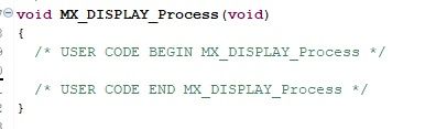

- With GFX02 "HelloWorld" example, there is nothing in MX_DISPLAY_Process(); function ??

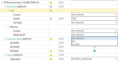

- With LCD configuration (ILI9341 drivers) configured on FMC, it's working fine because the MX_DISPLAY_Init() successful passed (ReadID OK).
- With memroy configuration, there is no QuadSPI configuration, only SPI. QuadSPI is only available with "custum" selection. So, if i select Custom + QuadSPI (and not MX25L6433 + SPI) I will loose MX25L6433 drivers produce with X-CUBE-DISPLAY soft  ...
