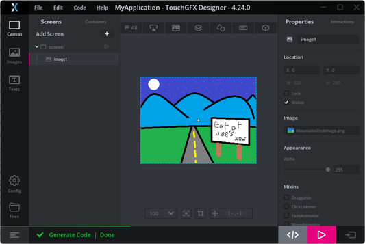

Now I'm trying to bring in TouchGFX into the mix and I'm having a difficult time. I've read through the board bring up process, and where I think I'm having trouble is knowing which functions to modify from the generated code to integrate the ST7789 driver code I've written.
To give you an idea of what I've tried and what my setup is, here's what my TouchGFX setup looks like in the IOC:
After generating the code, I used TouchGFX designer and opened the ApplicationTemplate.touchgfx.part file and then added a simple splash bitmap to the default screen:
(I know, I could quit being an electrical engineer and draw pictures in paint for a living, right?)
I then generated code, went back to STM32CubeIDE re built with no errors.
On first debug session, nothing happened on the LCD, which makes sense since I hadn't modified any of the generated code. Based on the example here FMC and SPI Display Interface | TouchGFX Documentation I realized I was probably supposed to modify flushFrameBuffer in the TouchGFXHAL.cpp file, so I did so like this:

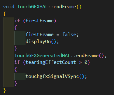

Hello @BWKidd ,
The flashFrameBuffer is used when a certain area of the screen has to be redrawn (basicaly when you invalidate something, change to a different screen, run an animation, etc).
What you should care about is that TouchGFX send a endFrame callback when it is done updating the whole screen. After that you are ready to update a new frame so you should send a vsync signal (do not use a timer for that):
The TouchGFX process is constantly waiting for a vsync signal.
Regards,
Gaetan Godart
Software engineer at ST (TouchGFX)
@GaetanGodart I hope you have been well! I'm finally getting back to this, and have managed a little success in that I am now able to finally get a screen I have designed in touchGFX to compile and display on my prototype setup. The bad news is I cheated and did what you told me not to do - I setup a timer and I've been calling OSWrappers::signalVSync() 10x a second.
I tried to implement the code your recommended in your previous post with TouchGFXHAL::endFrame(), but I wasn't certain what tearingEffectCount was, and further, It doesn't seem like TouchGFXHAL::endFrame() gets called unless OSWrappers::signalVSync gets called first.
So my question, or maybe request, is could you clarify how I should be triggering vSync? Many Thanks!

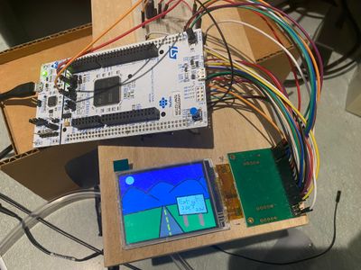

While I still need to resolve the correct way of calling the vSync signal, I did want to post how I finally managed to go from nothing to having screens from touchGFX Designer displayed on my setup. It might be helpful to someone else...or maybe just me, but here it is. Fair warning, there's a lot of detail because I get running into brick walls of knowing which button to push, or where to add this code, etc, and I know when I need to do this again in a year, I won't remember.

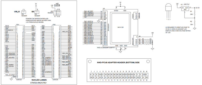

Hardware Summary:
Processor: STM32L496ZGT6U (On a NUCLEO-L496ZG Dev Board)
Display: NHD-2.8-240320AF-CSXP-FT (ST7789VI Driver)
Schematic:

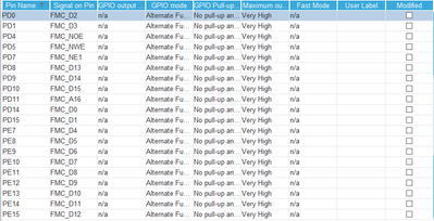

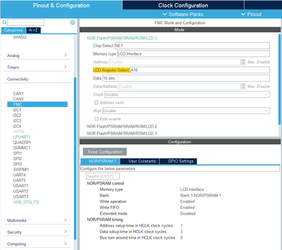

The FMC was enabled and configured:
Then the corresponding GPIO Pins configured for use with the FMC:

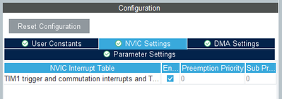

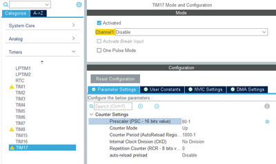

I also activated TIM17 to provide 1 millisecond interrupts for general periodic tasks.
The interrupt was also enabled within the “NVIC Settings” tab.
The timer was started in the User Code 2 Section of main.c:
main.c
/* USER CODE BEGIN 2 */
  HAL_TIM_Base_Start_IT(&htim17); // Start Timer 17

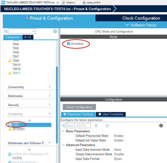

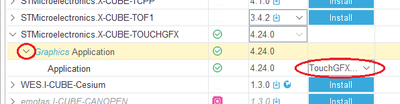

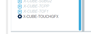

With all that verified and the display operating, I opened the ioc file and clicked on “Middleware and Software Packs” à “TouchGFX”
In the Software Packs Component Selector, I had to click the arrow next to the “Graphics Application” to expand it, then select “ToughGFX Generator.
In order to enable TouchGFX, I then had to enable the CRC module:

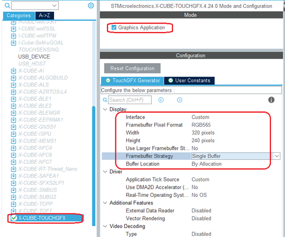

Back at the X-CUBE-TOUCHGFX item, I clicked the “Graphics Application” and configured TouchGFX:
After generating code, I got a bunch of errors related to TouchGFX files that were not found, so I then opened TouchGFX Designer, navigated to the projects associated “ApplicationTemplate.touchgfx.part” file, opened it, generated code using the BWKidd_10-1722629133480.png button. I had to repeat this process again (rebuilt the code in STM32CubeIDE and regenerated the code in TouchGFX Designer), and then build the code one more time. I’m not sure why but it worked.

Generating the code in TouchGFX Designer, and then building and running the code from STM32CubeIDE, I now get the image I added to TouchGFX Designer! Victory! Well, small victory anyways, but I’ll take it.
I've attached my main.c, ST7789_DRIVER.h/c files, modified TouchGFXHAL.cpp, and project IOC files.
