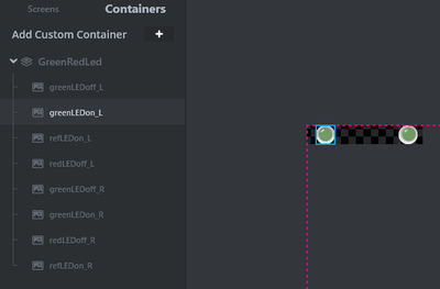

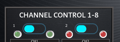

so it would seem from the above image I have started to learn about custom containers for the first time?
I understand a custom container can store multiple widgets
1) give the custom container a name
2) add your desired widgets to the custom container
in my case 8 leds, title each led to mean something, redLEDon_Left etc
I have added 8 led images to one custom container
4 LED images on the left and 4 LED images on the right
3) now you can drag and use your custom container multiple times on one screen or many screens I believe
4) now compile and generate code
5) now the tricky bit ......
working out how to access/reference and make multiple custom container arrays and the same for the child objects in the containers
but happy to have learnt about custom containers
