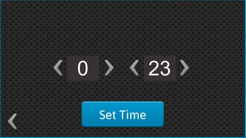

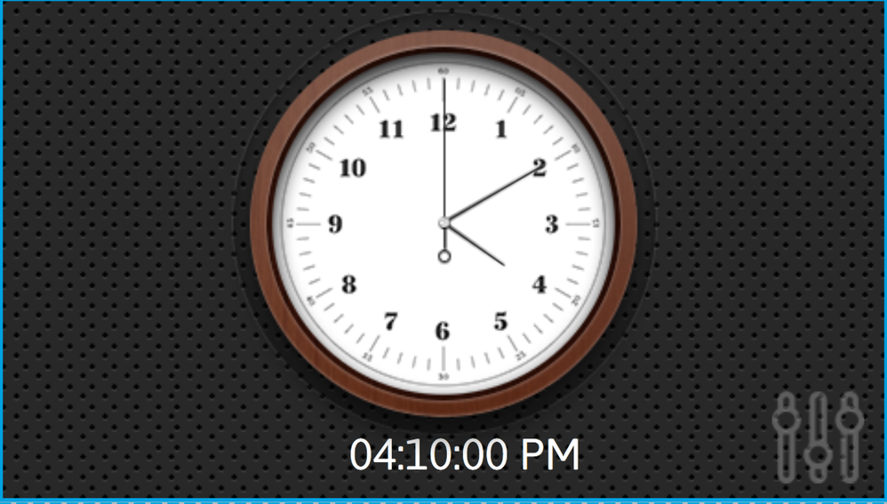

I was modifying an existing UI project that of the clock making the modification to create a second screen to make the modification settings of the clock. I quickly created the necessary keys and two text fields to be able to change the clock time.
Just to facilitate understanding, I attach the images of the first and second screens.

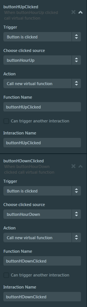

My problem is that while creating the interactions and setting new virtual function calls, I don't find them in the generated MainViewBase.hpp file as described in the tutorial.

I know it sounds silly but did you click on generated code ?
Because it is indeed very abnormal if you did and you cannot find the virtual functions prototype in the .hpp file.

sure I did GENERATE CODE, I even tried to delete the MainViewBase.hpp file in the directory C: \ TouchGFXProjects \ Test2 \ TouchGFX \ generated \ gui_generated \ include \ gui_generated \ and doing GENERATE CODE again the Designer creates me a new file but all I can't find interactions and setting new virtual function calls.
I can't understand what the problem is.

Could you start creating an entire new project ?
Add a button to the GUI and create a interaction that calls a virtual function when you click the button. Generate the corresponding code.
Tell me if this generates the correct virtual function prototype in the Screen1ViewBase.hpp.
You are using TouchGFX Designer 4.13.0 right ?
