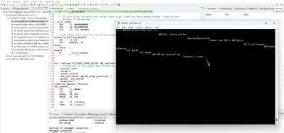

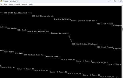

Hi @ERROR
I flashed you trusted binary as it is and it's working fine on my end!
Now, I'm suspecting your device or the USB adapter !
Best regards,
FBL

FBL
Hi @ERROR
It works on my end !
It is possible that your device is not working properly!
Best regards,
FBL

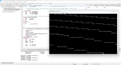

  • Z4C49001
Connections:
  • Laptop (USB Type-C) <-> USB hub (USB-A) <-> cable <-> board (ST-LINK USB Type-C)
  • A USB peripheral (USB drive, SD card, mouse, or keyboard) is connected to another USB hub, which is then connected to the board’s USER USB Type-C connector.
I also tried powering the board from an external 12V/2A wall adapter, as well as directly from the PC USB port without the hub. In all cases, there was no enumeration.
The USB hubs I used are inexpensive and different, and the behavior varies between them.
When I swapped the USB hubs, after plugging in the USB peripheral, the LD3 LED next to the ST-LINK USB connector lits up red, and no message regarding enumeration failure appeared (nothing works). Pressing the reset button does not help; I need to disconnect and reconnect the cable to the ST-LINK USB connector in order to restart the board.
Regards!

FBL
Hi @ERROR
I'm attaching the binary file. Did you select Software reset?
Do you use external loader check if it is selected correctly.
Best regards,
FBL
ERROR
Senior
Hi @FBL
Thank you for your firmware!
Looks like you use a dev mode. I tried to run your ELF in STM32CubeIDE - the enumeration failure is again (i used "software system reset").
Usually, I use a regular mode loading the binary to the flash memory.
I took your ELF and converted it to the binary with the line below
 arm-none-eabi-objcopy -O binary Ux_Host_DualClass.elf Ux_Host_DualClass.bin
Then I signed the binary and loaded it with the STM32CubeProgrammer to the flash memory at 0x70000000 (I use the external loader of course). The corresponding BAT file and converted files are included in the archive attached.
After that I set BOOT1 switch to the "L" position and reset the board. And I have the same "USB Device Enumeration Failure".
Could you please flash your board with BAT files in the FBL_USB directory (your fw), and FBL_USB_MY directory (my fw)?
PS. The USB port looks not damaged, because I successfully run USB devices examples, and the green LD9 lights up when I plug in a USB drive to it.
Regards!
