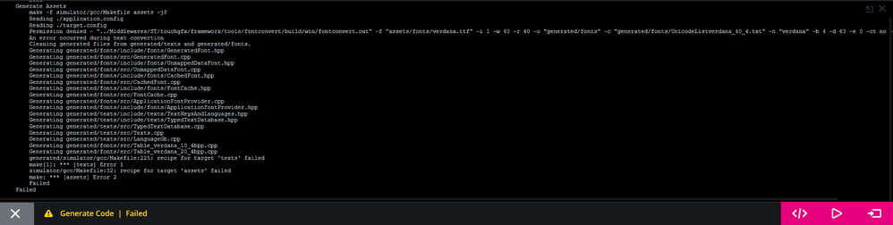

Hi, i keep getting this error. how can i solve it?
im using stm32h750-disco and touchgfx

Hello @Angle​ ,
Which version of TouchGFX are you using ?
Did you generate code both in Designer and CubeMX ?
/Yoann

touchgfx version 4.20 and stm32h750-dk eval board. no i generated code using stm32cube ie

i try with new version but at first stage already got this error
‎2023-01-03 5:15 AM
That is a very strange issue, are you sure that you are working in a project where you have the permissions to modify files ?
Did you try to create a new project using the stm32h750-disco board setup in TouchGFXDesigner, or did you generate code in a project created with a previous version ?
Can you also share your text.xml file please ?
/Yoann
