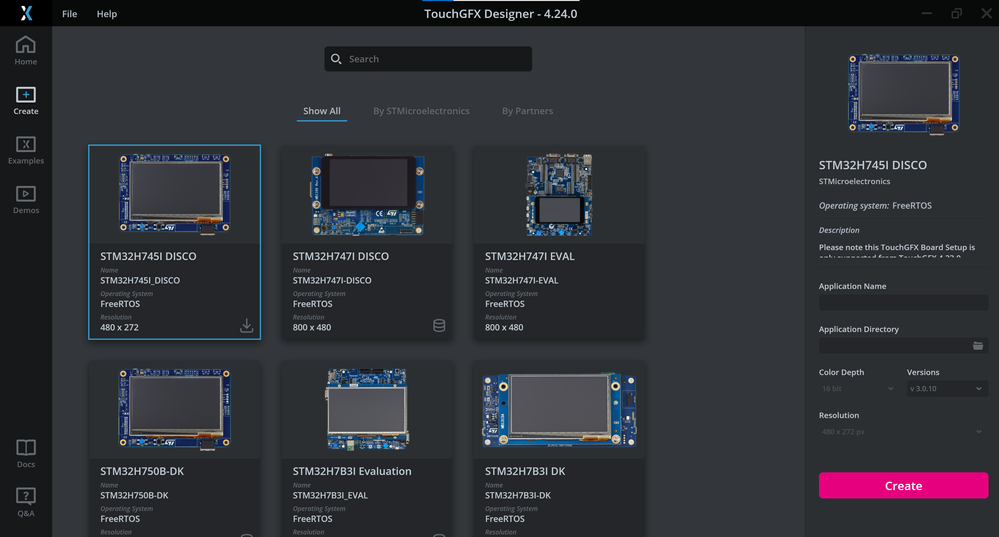

Eventually, you can speed up your development tremendously by using one of the STM32 boards that are available in TouchGFX since they are already configured to work with the basic functionalities.
TouchGFX Board SetupsTouchGFX Board Setups
