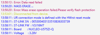

this error really drives me crazy. When trying to flash the programm from the ToughGFX App or CubeIDE the external Memory can't be erased. I use the recommended CubeMXVersion of 6.14 and have the latest CubeProgrammer and CubeIDE with STM32Cube FW_U5 V1.7.0. The whole ToughGFX log is attached. Thanks in advance!

Hello @LouisB ,
I have now imported the .stdl file that TouchGFX has provided for the exact board + external screen combination. When trying to do a mass erase, this error occours:
There is no write protection enabled for the adress of the flash chip in CubeProgrammer
I am also not able to connect the board to ST-Link Utility and updated the board with CubeIDE to the newest ST-Link Firmwareversion

LouisB
Hello @Neyus,
Did you try to disable read protection option byte ?
BR,
Louis BOUDO
Hello @LouisB,
yes, the read's out protection option was set to AA. The error still persists.
BR
Hello @Neyus ,
In cube programmer did you select the right external loader ? If not the one from your board is not bundle with Cube MX, but is available in your TGFX project.
1. Search for a .stldr file in your TGFX project ( go in the gcc folder) and copy it in C:\Program Files\STMicroelectronics\STM32Cube\STM32CubeProgrammer\bin\ExternalLoader .
2. Restart your CubeMx software
3. Go in the external loader tab and search for u575 gfx and select the one you just added
4. Now you can try a full chip erase on the external memory
BR,
Louis BOUDO
Hello @LouisB,
Yes, I have already imported the external loader from the GCC folder for this specific board combination into the CubeProgrammer, but I'm still unable to read from or flash the external chip.
BR
