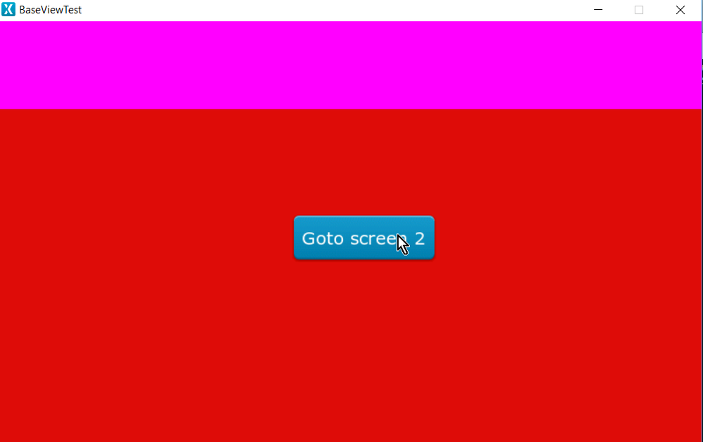

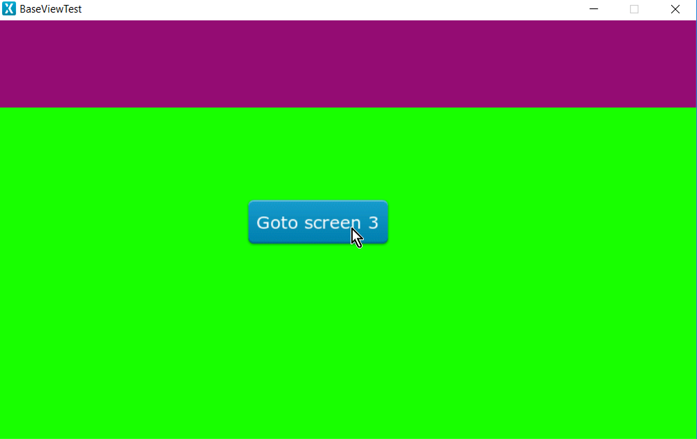

I'll update this thread as i go with improved functionality and project attachments. For now please find attached a project that will take you from screen1 to screen 2 to screen 3 to screen 1... (interactions and buttons for now) but using a shared BaseView interface that lets each screen set the color of their inherited TopBar. I'll get into details later.
Instructions:
Do not generate code from the TouchGFX designer or you'll overwrite the changes. I will come up with a script at some later time that you will insert into the post-generate-command to fix up all generated view groups.
To simply run the project without generating view code simply run this command from your TouchGFX environment:
make -f simulator/gcc/Makefile
Note: I removed anything but the win32 mingw simulator library to keep it small.
Below screenshots show two of the three screens in the application where each concrete View class calls a function defined in their base view to set the color of the inherited/shared top-bar.
