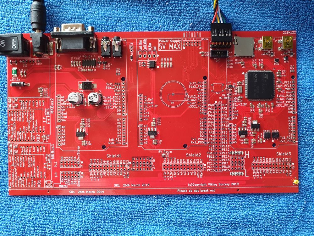

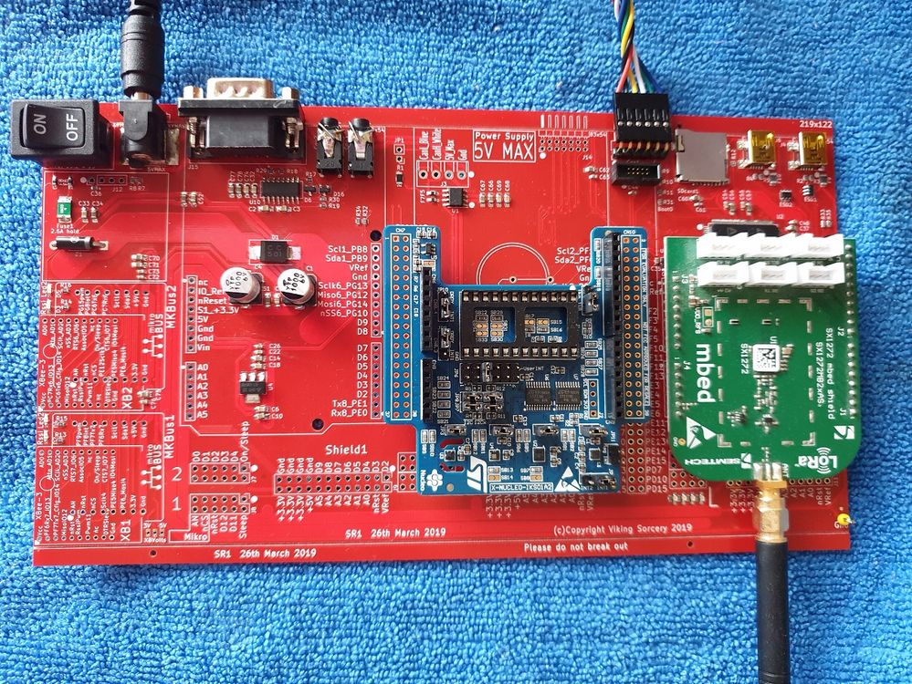

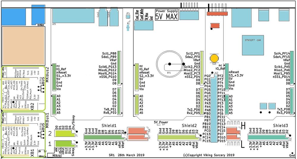

The F750 seems to be the faulty F756 parts re-badged.
I just made a new board to run the F750/F756
My new board will run 3 shields side by side, and 2 XBees / MikroBus
I have wired unique SPI, Uart and IIC ports for each shield
comes with a detailed and verbose connection manual...
Supports H753 H743 F750 F756 F722 F767 F733 F732
Most of the primary comms interfaces are prewired uniquely to each shield position,
many however are uncommitted but provided as a patchable block,
so inter-shield wiring can be customised, either between them or back to the STM32 uncommitted pin banks.
