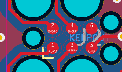

By the by, NRST is already connected to the J-LINK V2 - I placed a 6 pin Tag Connect 'receptacle' on my board with NRST, so I already have that available.
So, for now, I plan to solder wires onto the C091 to bring out a USART to an FTDI232 board I already have. I'll then redesign the board slightly to bring out USART1 to a 14 pin Tag Connect plug of nails and connect that to a new J-Link 3.
