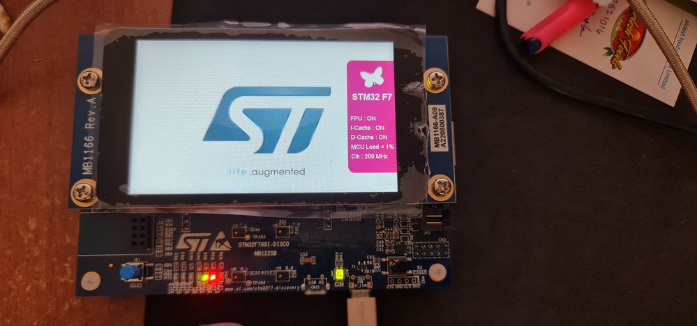

I have purchased STM32F769 Disco Board. Post powering board from CN16 power LED turned on. Nothing appeared on LCD as described in Demo firmware. I reprogrammed FULL demo firmware STM32769I-DISCO_DEMO_V1.0.0_FULL.hex. LCD is struck at Blue logo. Nothing happens after that.

I have went through the readme file and followed the instructions for flashing the full demo firmware. But it is not working. Post flashing I can only see Blue ST Logo.
I have downloaded binaries from
https://www.st.com/resource/en/compiled_demos/32f769idiscovery_demo.zip
If I flash STM32CubeDemo_STM32769I-DISCO_V1.4.0.hex binary from STemWin folder then I see the display as per attached image. It shows ST logo and and cpu specific details. But I cant see other icons showing options like audio or video player.
Not sure if received board has some defect or binaries has some problem.

I think board has some manufacturing defect. I checked with technical team of distributor.
They sent me the replacement. Replacement worked perfectly.
To debug I built multiple binaries from STM32Cube7 software package but nothing worked. Looks like some bad component (may be audio related) on board prevents firmware init process.
