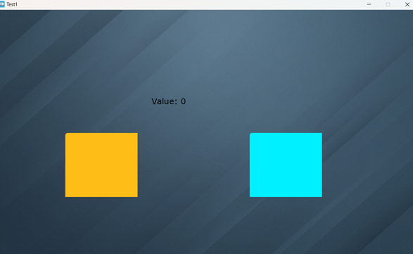

Hi Mohammad, yes I've added my files into the gui and tried adding the correct includes and the function to call under the #ifndef SIMULATOR guard but that didn't work either. I've started the project again and provided the files and what we have done again, please have a look and let me know if there is anyway around the issue, that would help. Thank you.
I added a new source and header file (.cpp and .hpp) with the following locations:
"C:\TouchGFXProjects\Test1\CM7\TouchGFX\gui\src\model\MathOperations.cpp"
"C:\TouchGFXProjects\Test1\CM7\TouchGFX\gui\include\gui\model\MathOperations.hpp"
We added these files in the default project that was initiated by Touch GFX Designer. In these MathOperations.cpp file we have two functions, addition and subtraction, which are being called in the model.cpp file to perform the arithmetic operations.
Below is the code for both MathOperations.cpp and Model.cpp:
MathOperations.cpp
#include "../../include/gui/model/MathOperations.hpp"
#include <cstdint>
uint16_t MathOperations::Addition(uint16_t x, uint16_t y) {
   return x+y;
uint16_t MathOperations::Subtraction(uint16_t a, uint16_t b) {
   return a-b;
Model.cpp
#include <gui/model/Model.hpp>
#include <gui/model/ModelListener.hpp>
Model::Model() : modelListener(0)
void Model::tick()
// Define the MathTest function for the Model class
uint16_t Model::MathTest(uint16_t x, uint16_t y) {
uint16_t Result = MathOperations::Addition(x, y);
   modelListener->GetResult(Result);
   return Result;
uint16_t Model::MathTest1(uint16_t a, uint16_t b) {
   uint16_t Result = MathOperations::Subtraction(a, b);
   return Result;
Currently, the code builds fine with no error at simulator and does what its intended for. When the yellow button is pressed, we get the sum of the values (The values which were passed from Screen1View ).
Similarly, when the blue button is pressed, we get the difference of the values.

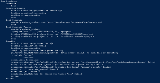

Problem:
When I include 'main.h' or any other files that are in core (such as gpio.h, spi.h, ...), inside the gui folder (MathOperations.cpp), the project builds fine in the IDE but shows an error in the simulator. We will be needing the core files in our projects and therefore we need to be able to link them with the gui files.
This is the error I get in the simulator:
I tried creating a source and header file in core but the error still persists. From what I understand, the issue seems to be with the paths since we are not able to call the files from one directory to another (Core -> Gui).
Waiting to hear from you.
