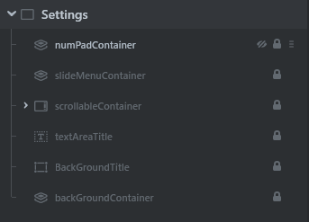

I build a custom Numpad Container. Iam setting it Visible when a textarea is clicked. And it is the top layer on the Screen. Trying to set other containers on a lower layer not touchable is not working.
I can still click the slide menu button und some other buttons on my Background container.
Is it a bug?
scrollableContainer.setTouchable(false);
slideMenuContainer.setTouchable(false);
backGroundContainer.setTouchable(false);
Solved! Go to Solution.

‎2024-02-20 7:51 AM - edited ‎2024-02-20 8:02 AM
Hello
Easy way to make your keypad 'modal' is first make keypad container size to match your screen size and move the actual keypad to the center of the screen, for example.
Then place normal box- widget to your keypad- container and match the size of it so that it equals your screen size. Put last in the list, i mean, behind the the other widgets of keypad.
Then put mixins - clickListener selected from that keypad background box.Then this box 'eats' all clicks which are not pointed to keypad area.
You can also set alpha value of it so that its fully transparent. Or make it partially transparent to get your keypad popup since other parts of ui are dimmed.
Then its enough just to set keypad visible true, not needed to work with touchable- property of other containers on the screen.
BR JTP

Inside each container, there are something you dont want to "touch" when your numpad is visible, have you tried to set not touchable what is inside those containers, instead of whole container?
‎2024-02-20 4:33 AM

Mz goal is to block all other inputs on the display. In the back there is a background container with a button to switch the language, set the time and some other buttons. I tried to block these buttons with the function setTouchable(false) and invalidate();. But this worked not for all the buttons in the background container. So i tried to block the touch input for the container.

I have two Callbacks. One from the textArea and one from the numpad Container.
void SettingsView::valueContainer_ClickHandler(ValueContainer *valueContainer)
numPadContainer.setVisible(true);
numPadContainer.invalidate();
scrollableContainer.invalidate();
slideMenuContainer.invalidate();
backGroundContainer.invalidate();
valueContainer_Ptr = valueContainer;
this->invalidate();
