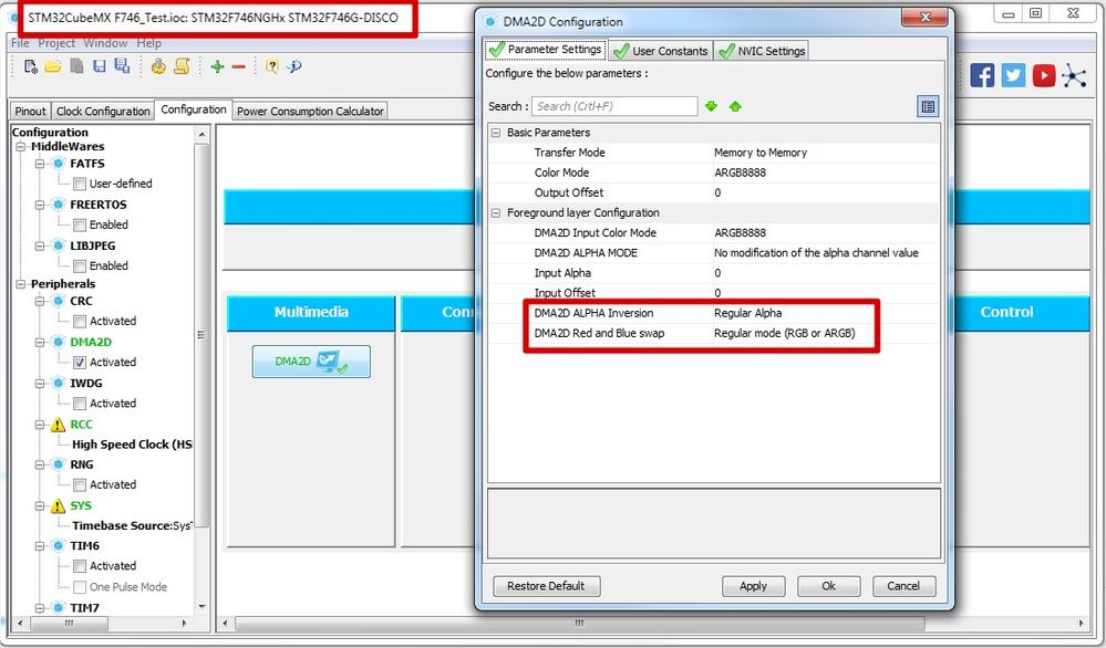

It is DMA2D config, generated CubeMX for Keil.
hdma2d.Instance = DMA2D;
hdma2d.Init.Mode = DMA2D_M2M;
hdma2d.Init.ColorMode = DMA2D_OUTPUT_ARGB8888;
hdma2d.Init.OutputOffset = 0;
hdma2d.LayerCfg[1].InputOffset = 0;
hdma2d.LayerCfg[1].InputColorMode = DMA2D_INPUT_ARGB8888;
hdma2d.LayerCfg[1].AlphaMode = DMA2D_REPLACE_ALPHA;
hdma2d.LayerCfg[1].InputAlpha = 0;
// hdma2d.LayerCfg[1].AlphaInverted = DMA2D_REGULAR_ALPHA;
// hdma2d.LayerCfg[1].RedBlueSwap = DMA2D_RB_REGULAR;
It is config for STM32F476IGTx. I must comment last lines for compillung.
It is line not for my processor
 (STM32F476IGTx)
This feature is only available on devices :
STM32F756xx, STM32F767xx, STM32F769xx, STM32F777xx and STM32F779xx.

Thank you for reported this issue. Iraised it internally to CubeMx team for fix.

Thank you very much for identifying the error and providing a workaround.
I could not figure out why I can't use DMA2D in my project.
I also have the same
error when I import
https://community.st.com/tags#/?tags=cubemx

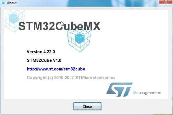

generated project into my IDE. I am using version 4.22 of CubeMX and
My Project is for STM32F7-DISCOVERY board
The IDE doesn't like these 2 lines of code:
 hdma2d.LayerCfg[1].RedBlueSwap = DMA2D_RB_REGULAR;�?�?
The compiler can't find AlphaInverted, RedBlueSwap, DMA2_REGULAR_ALPHA, DMD2D_RB_REGULAR
Commenting out those 2 lines, as Vitaliy suggested, got rid of those errors.

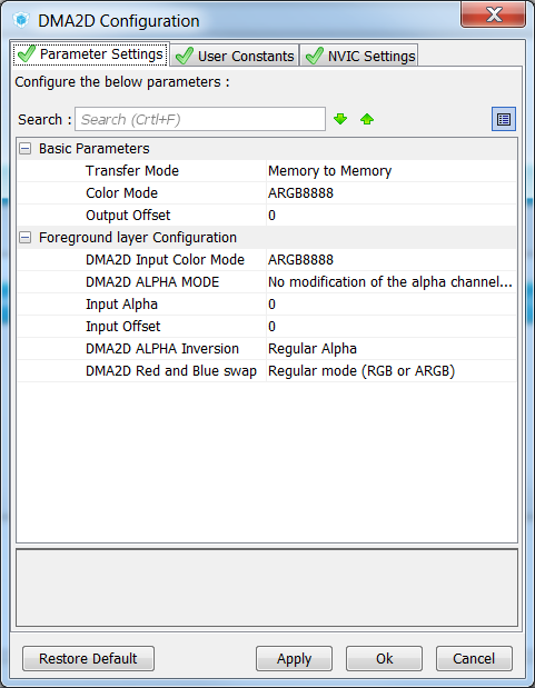

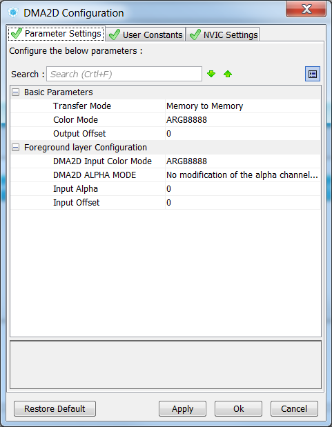

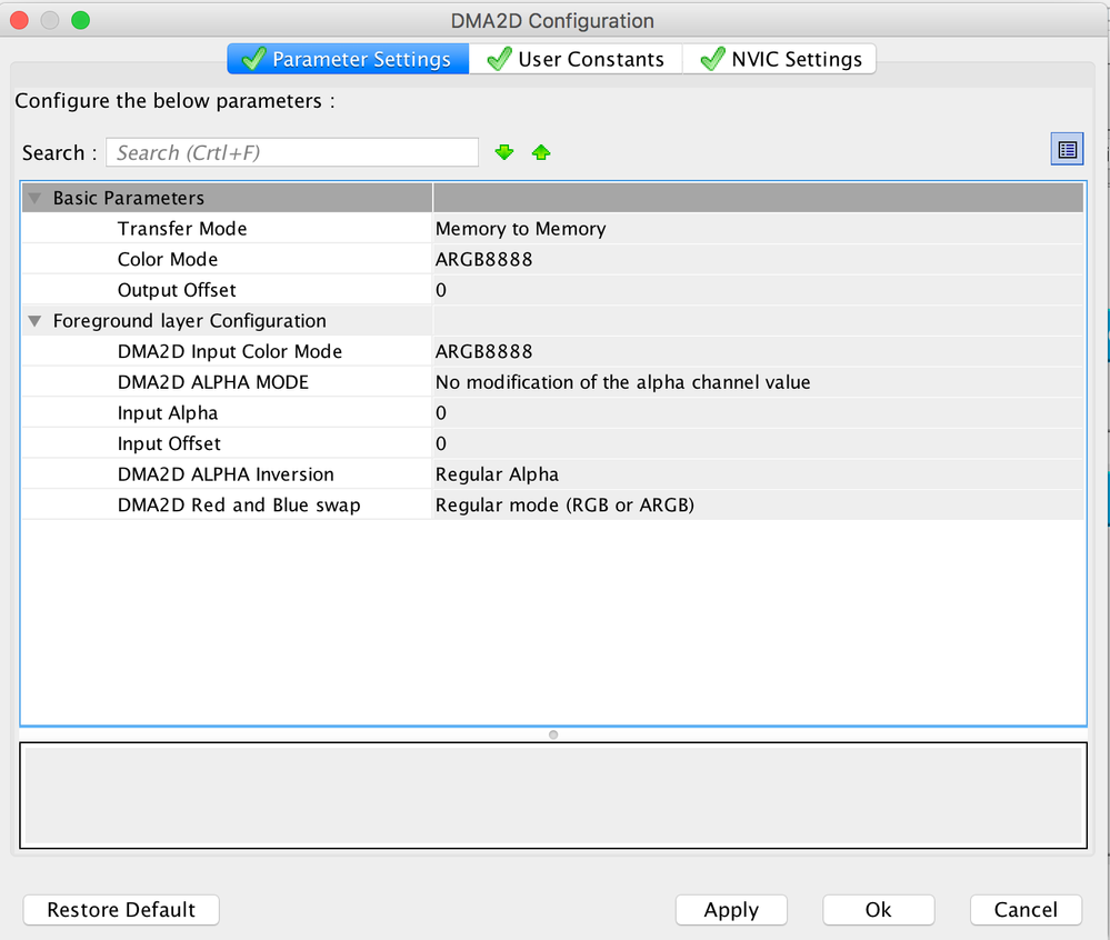

Can you please provide the ioc file for your F746 project?
CubeMX 4.22 does not provide the possibility to configure the Alpha inversion and Red&Blue swap parameters since they are not available for this MCU:
While indeed it is available for other series (ex: F767x):

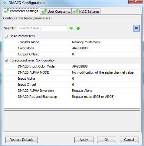

Posted on August 08, 2017 at 17:14
CubeMX (ver. 4.22) DMA2D config for STM32F746IG

Dear Cube-T.
Your screenshots show that the CubeMX should not have the options that Vitaliy and I  have,
Alpha inversion and Red and Blue swap when working on F746 chip. I downloaded mine from the ST.com Web site.
