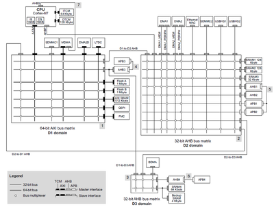

Hi
I configured the DFSDM1 on the STM32H753VIT6 for a MEMS Mic.
I got the problem that the DMA Callback on (Half)/Full buffer never gets called.
I used AN5027 as guideline and the DFSDM Audio Example
D-Cache disabled and set the Audio Sampling Frequency low (4kHz) to debug over UART.
Main (snippets):
DFSDM_Filter_HandleTypeDef hdfsdm1_filter0;
DFSDM_Channel_HandleTypeDef hdfsdm1_channel4;
DMA_HandleTypeDef hdma_dfsdm1_flt0;
int32_t LeftRecBuff[1024];
void HAL_DFSDM_FilterRegConvHalfCpltCallback(DFSDM_Filter_HandleTypeDef *hdfsdm_filter)
/*Never Reached*/

Hello @fwald ,
The problem is most likely the RAM location of your buffer.
On STM32H7 devices, the DMA cannot access DTCM/ITCM memories. Those memories are tightly coupled to the CPU, so even if the DFSDM is working and FLTRDATAR is changing, the DMA transfer will not complete if the destination buffer is placed there.
This is visible in the block interconnect matrix from RM0433:
So please make sure your buffer is located in a DMA-accessible RAM region, for example SRAM1 or SRAM2.
You can do that by placing the buffer in the proper section with an attribute macro, depending on your linker script, for example:
__attribute__((section(".RAM_D2")))
or another SRAM section that is accessible by DMA in your project.
You can find more details about this kind of issue in the community article linked here.
Also, if D-Cache is enabled later, remember that cache maintenance may be needed for DMA buffers.
So, in short:
  • DFSDM looks OK
  • DMA request / callbacks are not the real issue
  • the buffer is probably in a memory region not reachable by DMA
Move the buffer to SRAM1/SRAM2, and the callbacks should start working.
