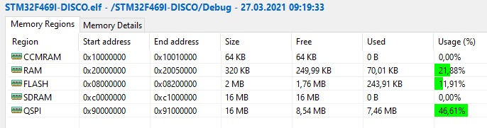

I am working on a Project mainly from my desktop PC, yet because I recently installed my board in a garden shed, I have to use my Laptop from now on if I dont want to take the board home again. For this purpose I simply copied my projectfolder from /.../TouchGFXProjects, to the same location on my laptop.
If I try flashing my STM32F469I-DISCO board from my laptop, somehow CubeIDE decides to not flash my external memory (QSPI). The result is a black screen instead of what I designed with TGFX.

So to my understanding it simply "refuses" to flash the QSPI... yet when taking a look at the build analyzer it looks like this on both laptop and PC:

‎2021-03-29 6:30 AM
Can you confirm that your linker script looks similar to below?
/* Memories definition */
MEMORY
CCMRAM (xrw) : ORIGIN = 0x10000000, LENGTH = 64K
RAM (xrw) : ORIGIN = 0x20000000, LENGTH = 320K
FLASH (rx) : ORIGIN = 0x8000000, LENGTH = 2048K
SDRAM (rw) : ORIGIN = 0xC0000000, LENGTH = 16M
QSPI (r) : ORIGIN = 0x90000000, LENGTH = 16M
If you download STM32CubeProgrammer standalone, are you able to browse memory location of QSPI after selecting the appropriate external loader? (You can find the external loader selected under Debug Configurations -> Debugger tab, Misc section)

‎2021-03-29 8:32 AM
Yes the linker script looks as above, yet I have found my solution. I reinstalled CubeIDE and when opening my .cproject file I make sure to have CubeIDE closed. I dont know which of these caused the board to flash normally but it works.
