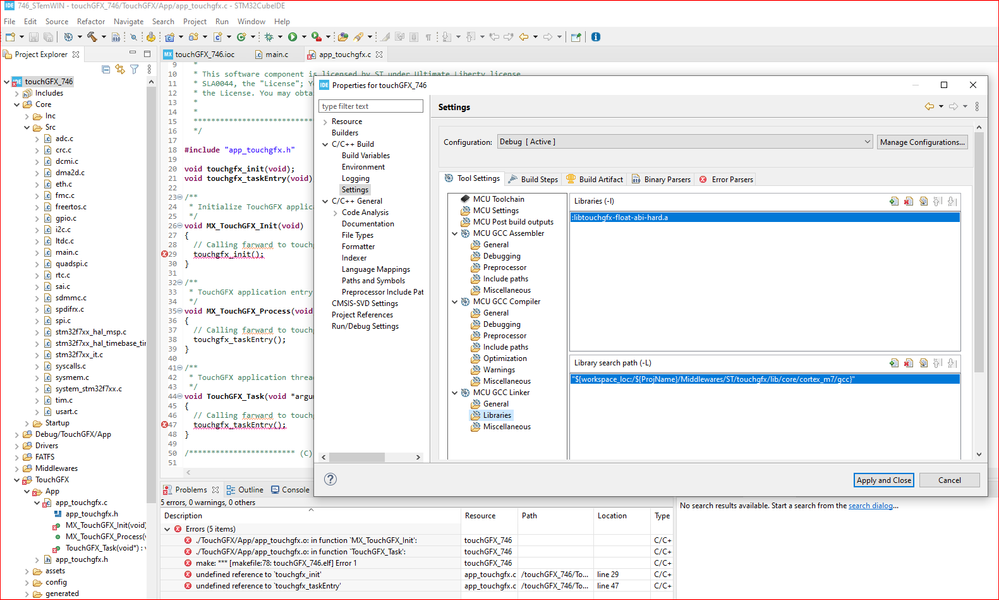

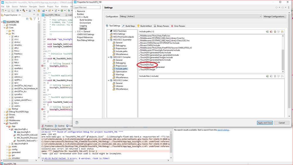

‎2021-08-24 4:49 AM
Hi MIKKELSEN,
thanks, I had found and followed the procedure and it creates the whole environment including touchGFX. But I still have a problem when I compile, probably I am missing a setting, the library has been added, I send the error screen.
What have I forgotten?
‎2021-08-24 4:51 AM
‎2021-09-01 1:25 AM
Hello MBosc.2
It seems you have create a C based project. As TouchGFX is C++ based you would need to C/C++ based CubeIDE project.
‎2021-09-01 1:50 AM
Popping in to inform you that you can convert your project to C++ by right clicking on your project in the Tree View on the left in STM32CubeIDE
