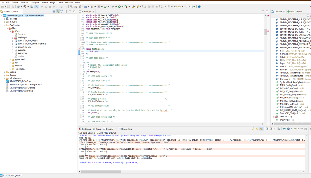

I have STM32 F746G discovery board and I generated project through TouchGFX designer and imported it to Cube IDE, but it generated main.c file.

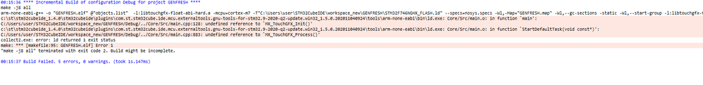

The project is C++ project, but when I try to rename main.c to main.cpp it will generate errors during compilation. I have no idea why I am getting these errors. Thanks in advance!
I have no idea why it is working with .c and not with .cpp
undefined reference to MX_TouchGFX_Init()
undefined reference to MX_TouchGFX_Process()

The main is supposed to be in .c as it is used by STM32CubeMX. It is TouchGFX that uses C++. It is usually never a good idea to modify the format of a file :grinning_face_with_sweat:. Could you explain how you imported the project to STM32CubeIDE ?

Instead of using the "Open Projects from File System" option you can just double click on the generated .cproject or .project under the /STM32CubeIDE folder. To convert to cpp you just need to right click on main.c in the tree view in STM32CubeIDE and check the "Update References" option.

Although it only appears to be main.cpp, when I try to use some c++ features it is not working. There is still main.c in Core/Src
