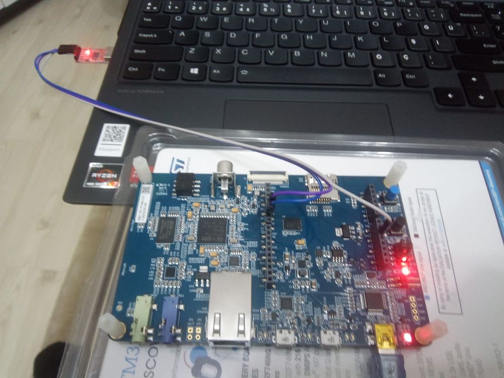

‎2021-01-03 8:31 AM
‎2021-01-03 8:36 AM
Seems you have converter, but scope ?

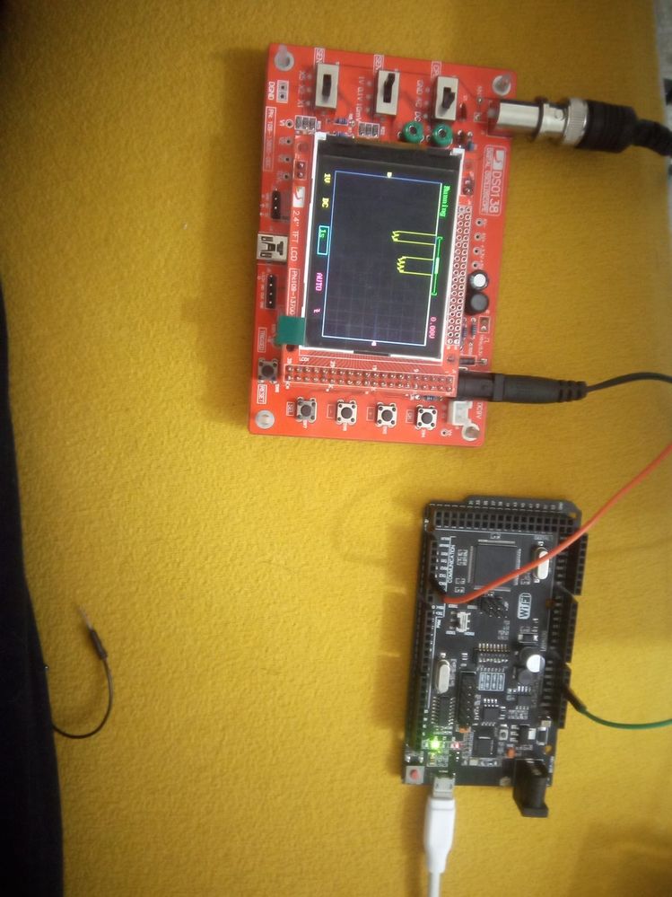

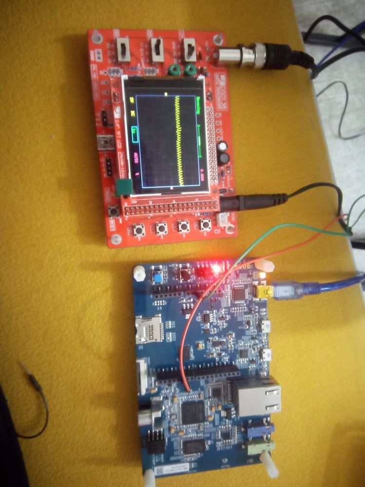

‎2021-01-03 8:51 AM
Arduino:
STM:

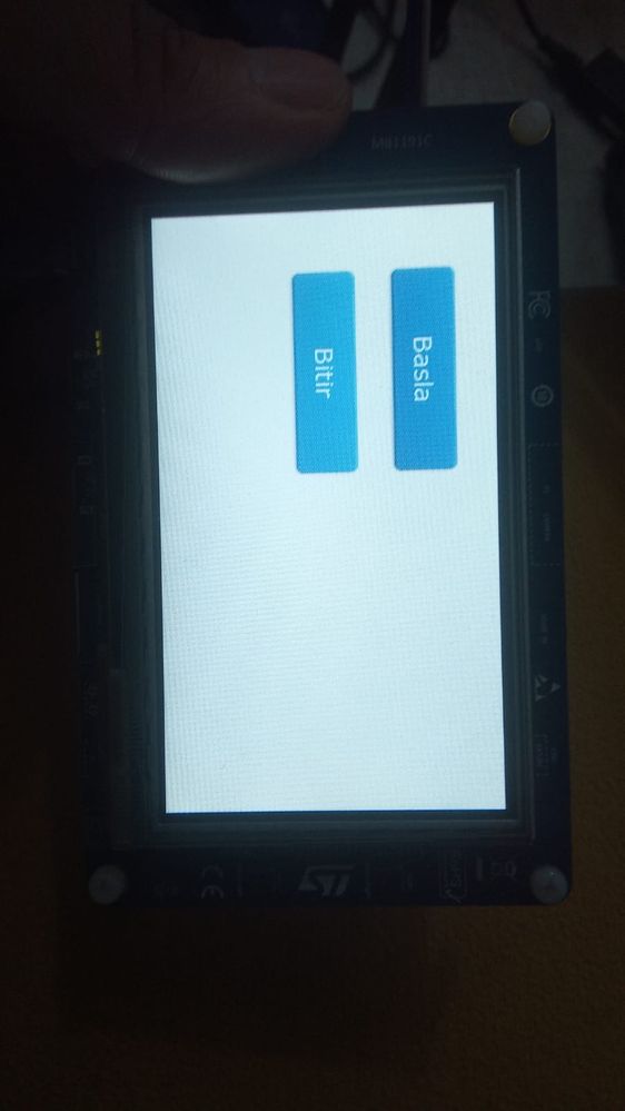

‎2021-01-03 9:09 AM
Maybe i dont understand your photo, but where you have touchGFX display and where you click ?
‎2021-01-03 9:17 AM
I click Basla Button.
