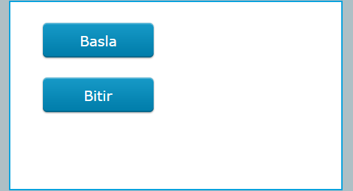

‎2021-01-03 3:15 AM
Hello
Thank you for replies.

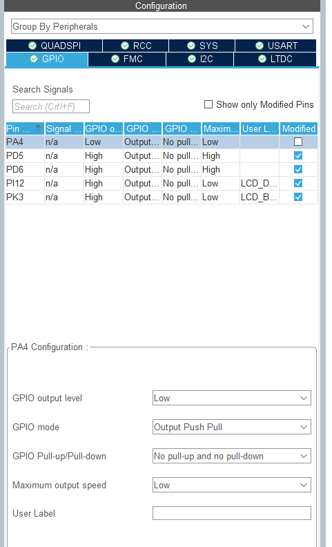

I created new project and added two button with two interaction.
I set uart2 D5 and D6 pins.115200 baud and polling connecting not IT or DMA.
I coded like you but same result . i cant send data from stm32746 to pc via uart.

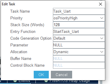

uart task i created in main.c
/* USER CODE END Header_StartTask_Uart */
void StartTask_Uart(void const * argument)
/* USER CODE BEGIN StartTask_Uart */
/* Infinite loop */
for(;;)
if (giden[0] != 0) {//icinde deger varsa
HAL_UART_Transmit(&huart2, (uint8_t *)giden, 10 ,30);
giden[0] = 0;
osDelay(1000);
/* USER CODE END StartTask_Uart */

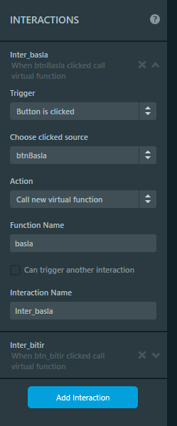

screen1view.cpp
#include <gui/screen1_screen/Screen1View.hpp>
extern "C"
#include "stm32f7xx_hal.h"
#include "cmsis_os.h"
UART_HandleTypeDef huart2;
#include "string.h"
extern char giden[];
Screen1View::Screen1View()
void Screen1View::setupScreen()
Screen1ViewBase::setupScreen();
void Screen1View::tearDownScreen()
Screen1ViewBase::tearDownScreen();
void Screen1View::basla()
strcpy(giden, "basla\n\r");
btnBasla.invalidate();
void Screen1View::bitir()
if (giden[0] == 0) {
strcpy(giden, "durdu\n\r");
btn_bitir.invalidate();
