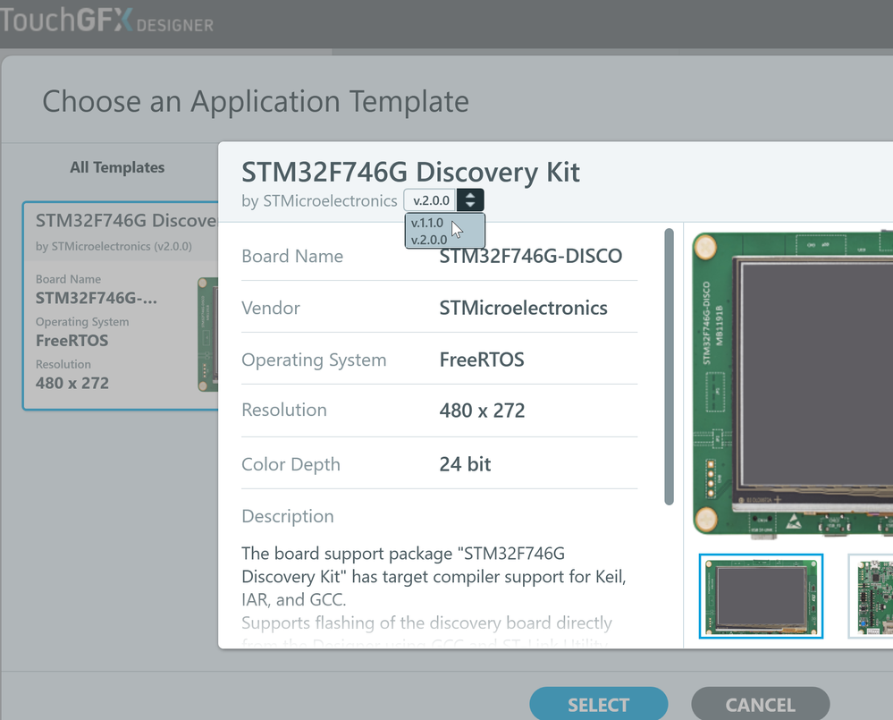

AT stands for "Application Template", sorry. It's basically the template for an STM32 based board you select through the designer.
If you use version v1.1.0 of the AT for STM32F746G-DISCO from within the TouchGFX designer, you will have a Keil project (but no .ioc file) - How would that work for you?
Thank you .. this is more than enough for me .. I can setup whatever peripheral I need manually I don't really need CubeMx that much
