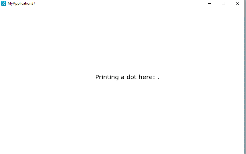

I need to take input fractional values from user through UI built via TouchGFX.
There is a separate Dot button on my UI keypad. But, I am not able to print it on the screen.
Please help me for above problem. Just a short clue on what to use will also be sufficient.
Sharing the photo of my keypad here with.
Martin KJELDSEN
Chief III
Concretely:
  • For the typography you're using you must define a dot ('.') in your wildcard list in the texts tab.
  • Call Unicode::strncpy(myBuffer, ".", 1); to update the buffer and invalidate the textarea.

You can use Unicode::strncpy() in TouchGFX to copy those kinds of characters into an array of Unicode::UnicodeChar (a wildcard buffer).
Martin KJELDSEN
Chief III
Concretely:

Yeah.. Tried the above methods and now getting proper output!
Thank you very much!!
