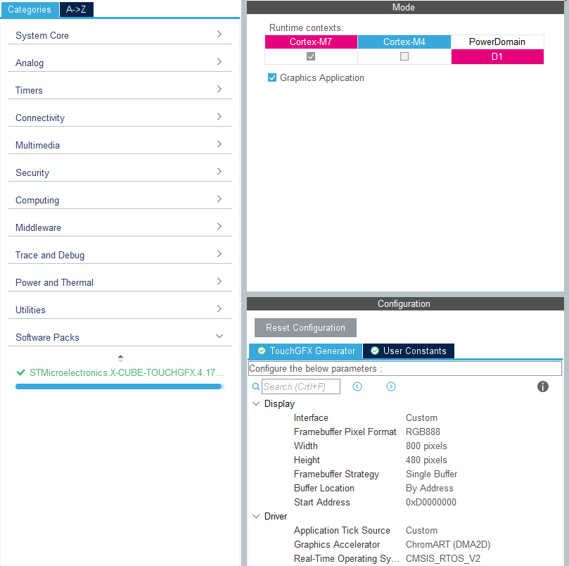

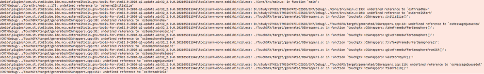

  • Build project (in my case, compile error occurs)

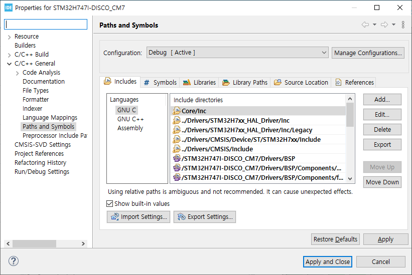

Attached my project.
Please advise for me, thanks.
6 REPLIES 6
Ethan HUANG
It seems to me you could figure this out by following page 2 of the attachment. Meanwhile, I would suggest you to disable binary generation as shown in page 3 so you do not need to spend much time waiting for big binary (>2GB) generation.
