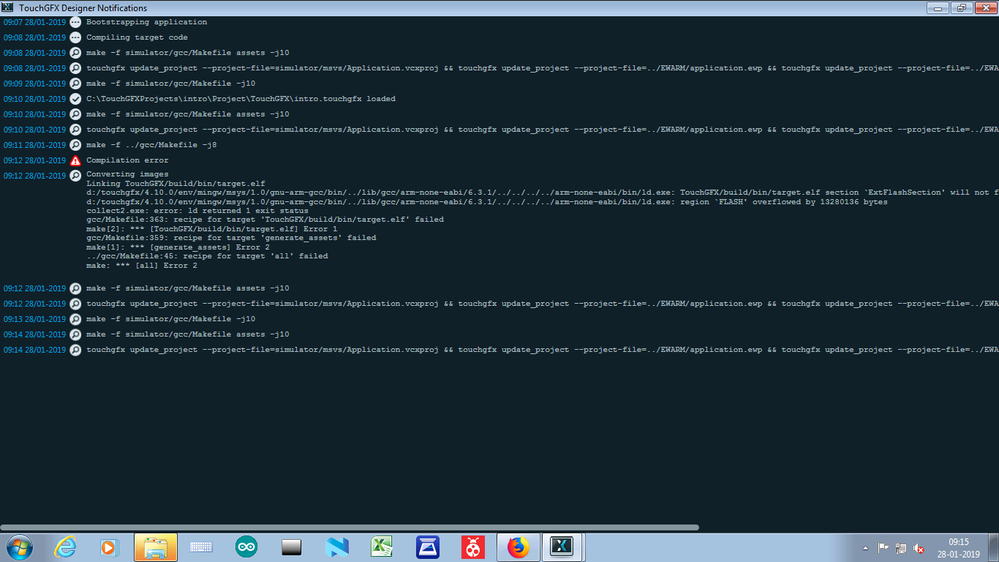

i have making a project which i can simulate the project but i can't run the same on my target.

Hi @NS.16​,
Looks like you have too many graphical assets in your application. The linker is telling you that you've overflowed the allowed limit. This problem won't happen on your windows machine, naturally.
Do you have a lot of full screen images?

‎2019-01-28 12:44 AM
yes i have..
Actually i have try to make a video using pictures..
about 103 slides..with 240 x 320 resolution images

Hi @NS.16​,
TouchGFX supports dynamic bitmaps. You can use something like libJPEG to decode jpeg images into dynamic bitmaps that are then updated on screen. We have this in several demos. If you use something like STM32F769 you then also have the option to hardware decode these jpeg images rather than using software (ligJPEG).
