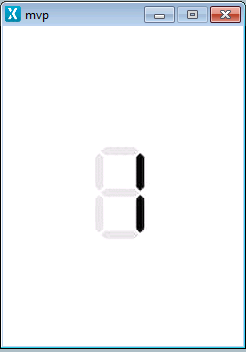

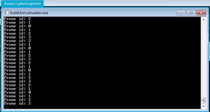

I have a doubt in my project.Actually i want to increament 7 segment display number so that i include every number as a picture.Actually i have already watched the gpio task webinar.By reference i do the same by increment the every picture using setBitmap function.But i can only increament the only one picture that was shown 0 to 1 in below .But it simulator it increaments 0 to 3 again 3 to 0 as my per program that value is not shown in my display.Why i can't increament this picture in my display.
This above image shown increament 0 to 1.But i want to increment 0 to 3 but i can't it stays on 1 after 0 to 1.
