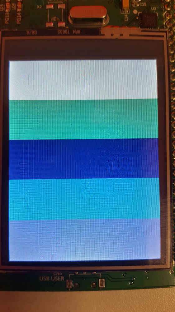

To test whether I could get the correct colours on the screen, I split the frame buffer up into five bands hoping to write from top to bottom the colours black, blue, green, blue and white. Note for this I am not using STemWin but just writing data straight into memory. This way I have complete control over what is going into the frame buffer.
According to the CLUT being sent down, the index values and their associated RGB values for this test are:
Index 0, RGB 0x000000 (Black)
Index 5, RGB 0x0000FF (Blue)
Index 30, RGB 0x00FF00 (Green)
Index 220, RGB 0xFF0000 (Red)
Index 255, RGB 0xFFFFFF (White)
The resulting image was as follows:
Of course, this is all assuming in L8 mode that the pixel format is D7 D6 D5 D4 D3 D2 D1 D0. I've not read anything in ST's data sheets to suggest it isn't that way.

‎2017-08-22 9:03 AM
>It's interesting that you configure the CLUT before enabling it.
As far as i know, you can not configure the clut if it is busy converting the framebuffer to RGB colours aka draw the Screen.
>unsigned int *ptr_BGR32_Palette;
Please notice that the CLUT Needs 32 bit colour values in ABGR 32 bit Format, not RGB 24 bit.
This might be wrong and not enough Bytes to fill the whole CLUT completely resulting in wrong colours.
Did you use my RGB_colours Lib like recommended ?
>My FAE is telling me that no changes need to be made to the configuration of the
> ILI9341 to accomodate the switch to L8
The ili9341 is connected with 18 data lines on the STM32F429i-disco, you can use the LTDC with 18 or 16 bit mode.
With CLUT mode enabled, the 24 bit colour values are reduced to the selected Output by removing the lower unnecessary bits of each colour channel. The Ili9341 doesnt care because the LTDC is drawing the Image.
