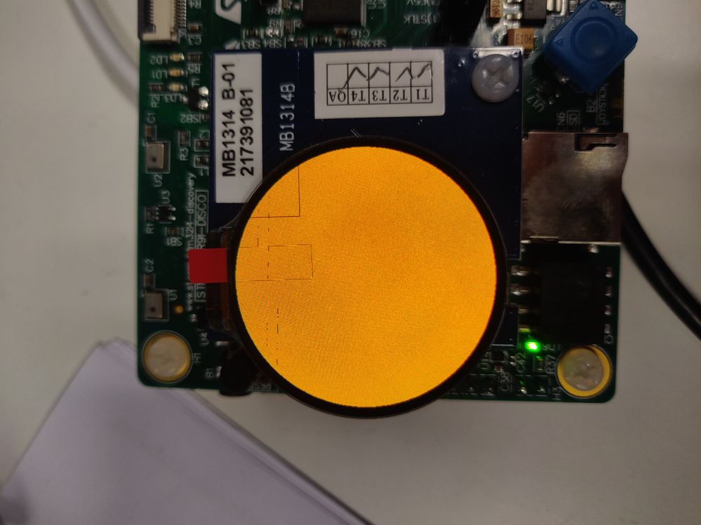

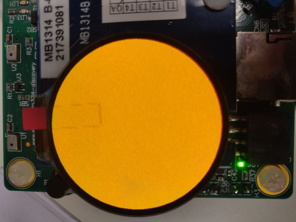

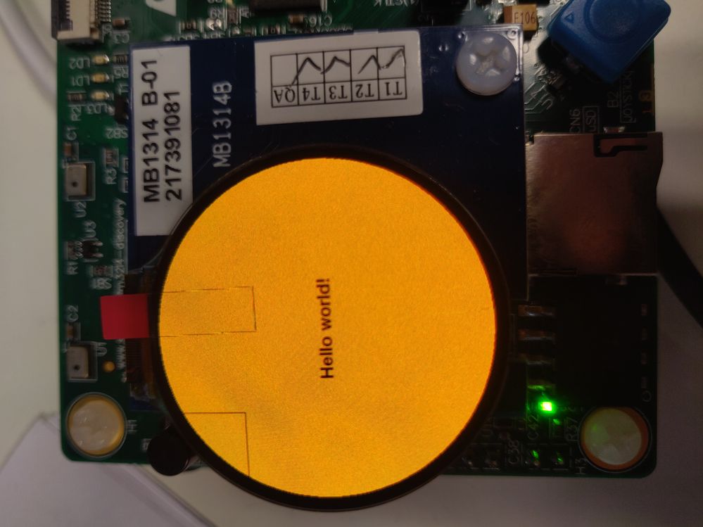

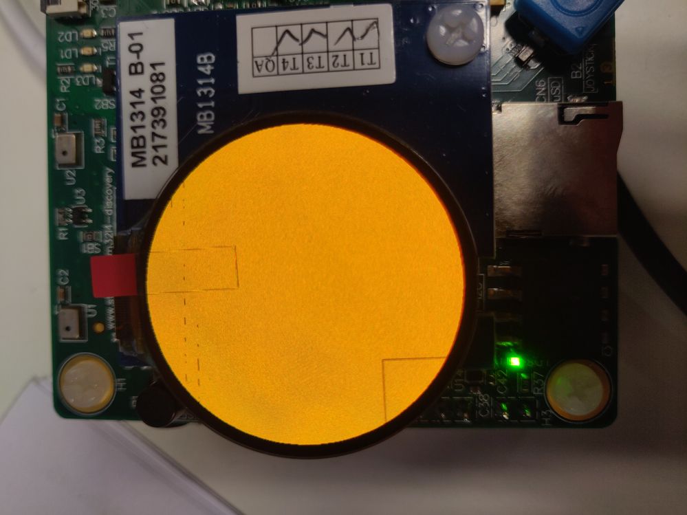

I would like to reverse the screen orientation on the Hello World example for STemWin provided in STM32Cube_FW_L4_V1.14.0
I have understand that the simplest way to do that is by selecting the LCD driver following the desired screen orientation as describe in section 33.5 Display orientation of STemWin user guide.
The only modification made in the example project is adding the folowing after GUI_DispStringHCenterAt :
 GUI_DrawRect(10,10,100,100);
Here is the result with the configuration :
#define ORIENTATION_0 ROTATION_0
#define ORIENTATION_0 ROTATION_CW
#define ORIENTATION_0 ROTATION_180
#define ORIENTATION_0 ROTATION_CCW
Did I miss another configuration in LCDConf.c ?
