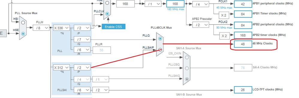

I am using the STM32F469 Disco with a custom display connected.
Everything wiorks fine.
Now i want to use the USB Port, which needs 48Mhz.
For that i had to change the SYSCLK to 168 which was 180 Mhz originally.
Everything works still fine, but when i do a fade-in of a picture, it flickers.
Then i was looking to the Datasheet of the SDRAM N25Q128A and on some other websites i found that this may be a problem of the dummy cycles which needs to be changed.
APB1 was 90Mhz with 180 Sysclk and now i have 84Mhz.
This are the parameters in the header file of the N25Q128A:
#define N25Q128A_DUMMY_CYCLES_READ 8
#define N25Q128A_DUMMY_CYCLES_READ_QUAD 10
I played around, increase by 1, decrease by 1 and so on, no better result. Still flicker during a fade-in of a picture (Alpha from 0 to 255).
In the "stm32469i_discovery_qspi.c" there is the "s_command.DummyCycles" in every function like read, write, erase.... which is mostly set to 0, only in "Read" and "EnableMemoryMappedMode" is is linked to the "N25Q128A_DUMMY_CYCLES_READ_QUAD" define.
If i change back to 180Mhz Sysclk which gives me 90 Mhz it works. But i need the 48 Mhz for the USB so 168 needs to be set up.
Does anyone had the same problem and a solution or can explain the effect on changing the clock to other peripherals?

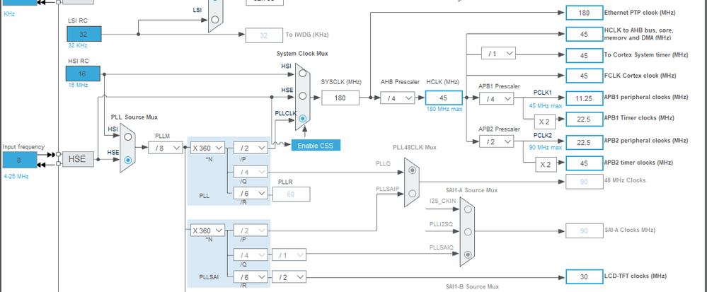

FYI, I left my SYSCLK at 180 MHz, and lowered my HCLK to 45 MHz using the AHB1 Prescaler, and my fades don't flicker (but I'm not doing any full-screen fades). Not using the PLL48CLK, though.
Fades are very processor-intensive - do you have the same flickering with smaller pictures?

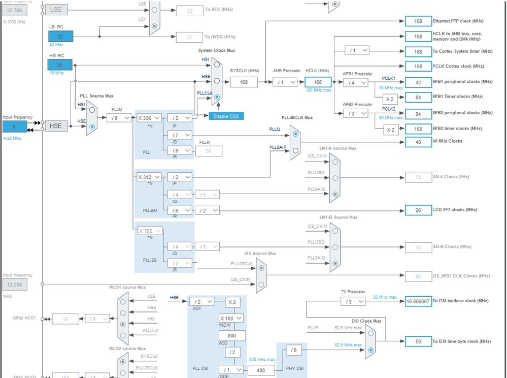

Yes, on 180 MHz i do not have any problems. But i need to activate the USB and this needs 168 MHz, so the only way to get that is this setup:
I tested fullscreen fades and smaller ones. On smaller ones the whole screen got some "flickers" during the fade. Wipe transitions are ok.

Can't you generate the 48 MHz clocks via the PLLSAI ?
Slow down the QSPI bus clock
hqspi.Init.ClockPrescaler = 1; // Make BIGGER, ie 2

If LCD_TFT clock could be lowered somewhat to 24MHz (I don't know what are the ramifications of this), 48MHz USB clock could be generated in PLLSAI, while retaining the 180MHz sysclk generated in "main" PLL.

Unfortunately my display works only perfect with 26MHz, i already tested for hours to play with the values of the display to get it working without strange behavior but i had no success.
But what are you guys thinking when everything works good with 180 MHz and with 168 MHz the display has problems only with stuff like fade-in functions.
Other movements like wipe/swipe (except slide transition, there i still have a lot of problems with a clear picture but not important now) work perfectly.
Changing from 180 to 168 MHz and some flickers at the screen during fade-in should be something wrong with the external memory (framebuffer) ?

With respect to your slide transition, FYI if you are using 4.19.1 of the Designer there is a known bug when swipe transitions are used.
Is your screen size still 480x800? And when you say flickers, are you getting partial screen artifacts or is it just not 'smooth' fade, like you are missing some alpha value updates? Maybe the render time is causing you to skip frames. What is the size of image you are trying to fade?

I just tried doing a 2 second fade of my background image on my main screen. It actually took 11 seconds to complete (of course, my HCLK is 45 MHz). As I expected, there were jumps in the alpha value of each update, but nothing 'wrong' per se, with the screen.
I also tried setting my SYSCLK to 168MHz and changed divider back to 1, to be just like your configuration. My LCD-TFT clock is still 30 MHz, though. I added a 480x732 image and faded it in just fine, other than taking 5 seconds instead of 2.
