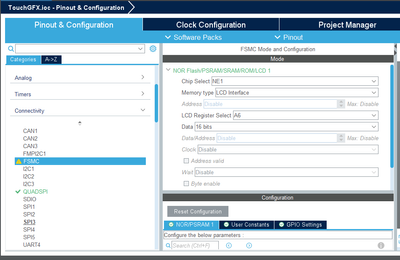

I'm using NHD-2-8-240320AF-CSXP-FCTP display. I try to get a white background on my LCD panel. However, it isn't operating. To interface with an LCD, I use FSMC.
Where I made mistake. Please any one help me

STM32F423ZHT6 lacks an LTDC controller and . How to use it?
1. Could you please provide more details on your issue?
I don't know how to access the display via STM32CubeIDE. Please provide any example code to access the display panel where I put LCD initialization code.

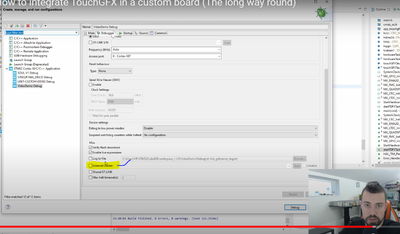

I refer this YouTube video: https://youtu.be/SRQD8JMeg_k?si=bGmAo4KQ7zLAYZx5
This video displays an external load checkbox while he debugs the project. But this isn't displayed in my project.

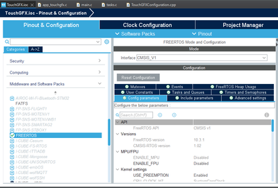

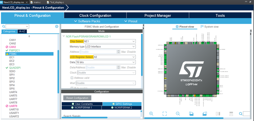

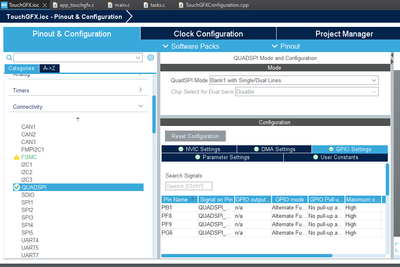

This my pinout & Config

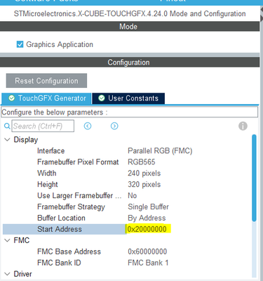

In STM32CubeIDE -> .ioc file -> X-CUBE-TOUCHGFX -> Display -> Buffer location- By Address and Start address-I put 0x20000000. This is a SRAM1 memory. This is correct or not. If not means what I choose.
Can you help me which file I should insert this specific LCD init code?
