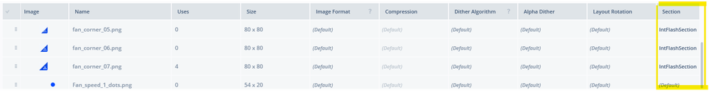

For the assets, please check in your TouchGFX project that they're in internal flash.
